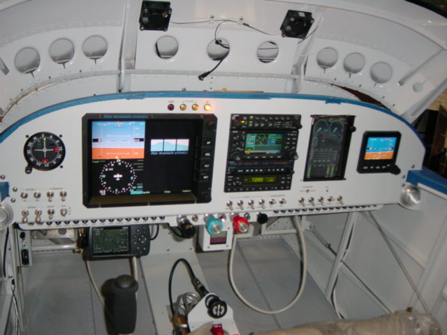

PostPosted: Wed Dec 27, 2006 7:53 am    Post subject: Re: Avionics Switch Reply with quote
Steve,
I have completed the electrical/avionics portion of a RV-7. It's a dual batt, dual alt, dual electronic ignition, all glass panel, etc. I opted for avionics master (2) switches although there seem to be arguments against their necessity.
I will attempt to attach a .DXF file of the electrical schematic and pic of the panel.
If that doesn't work I'll be glad to send them seperately if you're interested.
Roger
