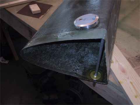

PostPosted: Wed Dec 20, 2006 4:33 am    Post subject: 601XL fuel vents Reply with quote
Wade
I modified a pair of long range tanks from ZAC. Gave me a chance to look inside. The vent tube is not attached at the top at all. It is beveled on the top end and is positioned with the end about a 1/4 inch from the top outboard corner of the tank. My modified tanks did not work out real well so I made a new set with carbon fiber. I am attaching a photo of one of my new tanks during construction. You can kind of see the vent tube location. The CF tanks have tested well but aren't flying yet.

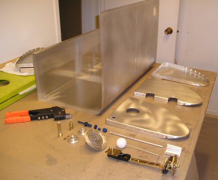

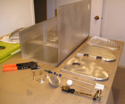

This is my experience making an -HD tank, but maybe you can use the idea.
I wrapped a piece of aluminum at the top of the tube, and riveted that piece with the tank's side.
See attached picture - I have higher resolution, (~700 KB). Let me know if interested and I'll send privately.
Carlos
