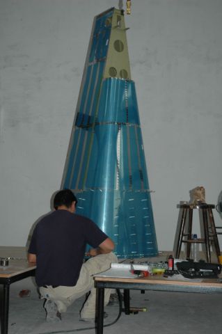

jesse(at)itecusa.org
PostPosted: Mon Dec 18, 2006 10:35 am    Post subject: tailcone rivets Reply with quote
This has worked great for us.
Jesse Saint

I used a back rivet plate; flipped the cone over on it's top and made sure it was on the plate. Because the cone overhung my table, I could stand in the hole of the missing forward top skin and lean into the cone. To be sure I was flat on the back rivet plate, I used a 1" (or so) round stick-on bubble level laid right next to the rivet I was going to smash. Because it was a little bit of a tight fit between the stringers, I could lean left or right and the cone would rotate until the bubble was centered. I don't recall having to drill out any of the rivets set with this method.
Hopefully, John will pipe in and direct you to his website where this technique is documented.

Stand the thing up and stand inside it. Back rivet all but a couple of rivets. My fifteen year old son on the outside with the bar and me on the inside driving rivits.
Finished the cone tonight. Happy:)
Thanks for the tip Jesse.
