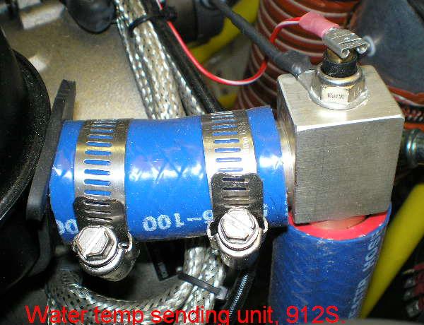

I made one from aluminum because of the heat consideration and that is also where I get my true water temp. and not the combo CHT/Water temp. that Rotax gives you. See picture below.
