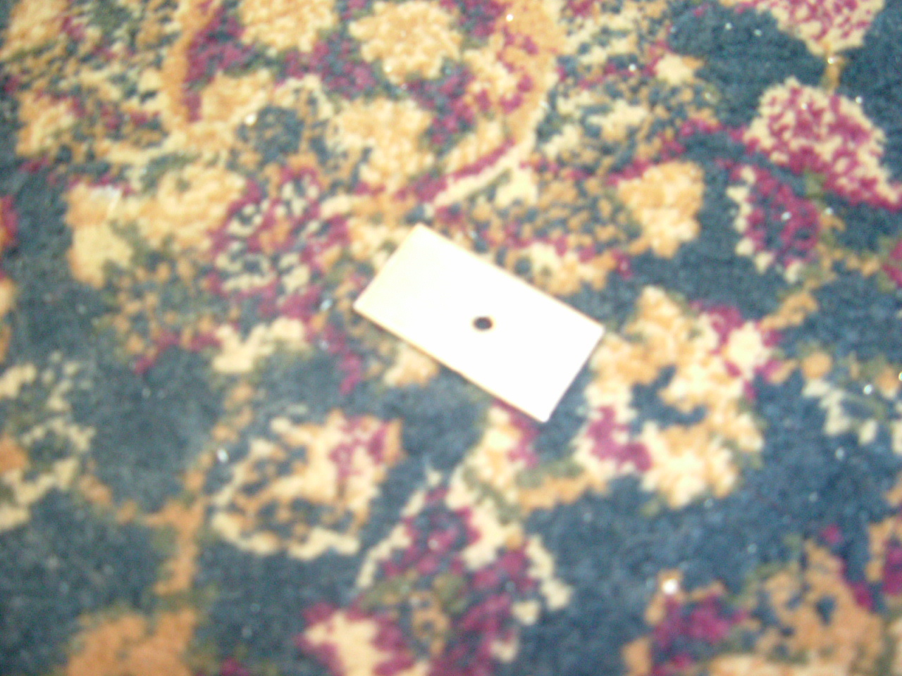

Sorry if this is a little anal, I have spent many years trying to get the best looking rivets I can. I have piles of scrap that I drill holes in and look at with a magnifying glass. Rivet and inspect, change the technique a little here and there then drill and rivet inspect until ,In my opinion we do some of the finest riveting on RV’s. Every airplane we do get’s a little better and a little faster.

Noel, thanks for the informative post. Can you enlighten me about point number 3f, below? I'm not getting the mental image of what you're saying.

One more picture of the shim itself
