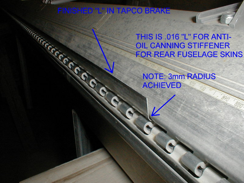

Here's a pic of the Tapco brake bending lite "L". I built up the sharp nose to achive the radius with layers of aluminum flashing. I also had to adjust the clamp down pressure to the max to clamp material in place. I've bent every piece for a 701, .032 and under, including the landing gear channel, etc. The .040 pieces such as the rear fuse longerons are too thick for this brake. For more discussion about these brakes, search the archives with the term "tapco". All in all it has done the job.
Just so I could bend the .040 & larger, I found & bought a used Roper-Whitney 8' x 16 ga shop brake, now I can bend it all. I still use the tapco for the thinner stuff.
Randy L. Thwing, Las Vegas
