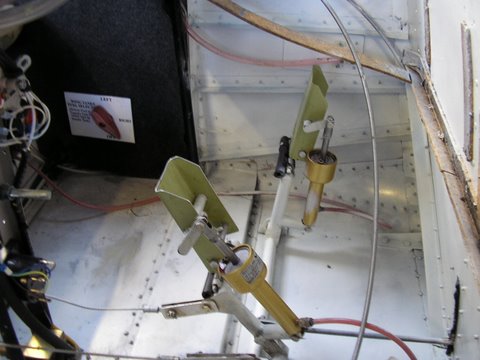

Hi list
I attach picture of plate we have added to brake pedals with is this we find we can hold the plane to run up with the continental o-200.
  Without we could only hold at 1500 rpm with difficulty
Clive
