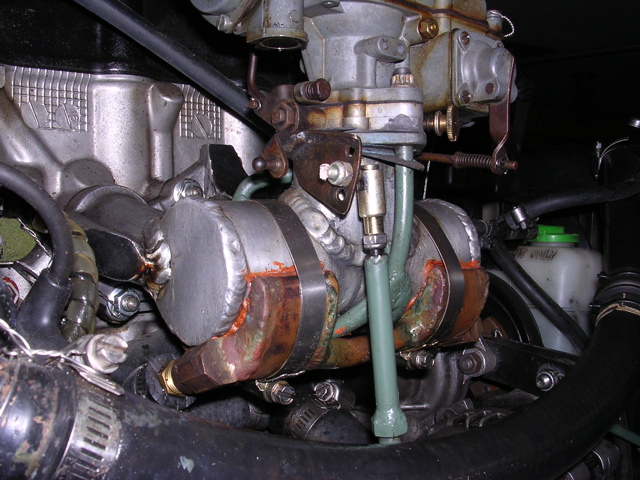

PostPosted: Wed Dec 13, 2006 10:53 am    Post subject: Electric Carb Heater? Reply with quote
Robert, both approaches will reduce the volume of the air charge
reaching
the cylinders but the water heater is superior. Naturally depends on
whether
you have hot water available.
This is my homemade water heater strapped to my homemade intake
manifold.
It was an after the fact fix to both help vaporization and prevent carb
ice.
Works well.
BB

PostPosted: Wed Dec 13, 2006 11:15 am    Post subject: Electric Carb Heater? Reply with quote
What are you running for a carb? Looks like an old one barrel Holley.
Rick

PostPosted: Wed Dec 13, 2006 11:18 am    Post subject: Electric Carb Heater? Reply with quote
Bob --
Why is the water heater superior? If the water is, say, at 180
degrees, and an electrical system generates, say, 90-degrees, (or 180
if you twist the rheostat!), then why would the water heater system be
superior? (This isn't rhetorical... I really want to know! Smile
-- Robert

PostPosted: Wed Dec 13, 2006 11:38 am    Post subject: Electric Carb Heater? Reply with quote
antique one barrel solex...

PostPosted: Wed Dec 13, 2006 11:48 am    Post subject: Electric Carb Heater? Reply with quote
RHEALLY now!
Maybe my isolated opinion, but in my case the heat gets added to the
incoming air after the venturi which maintains the volumetric capacity
of the (rather small) carb.
The heat from both the aluminum intake manifold and the saddled
muff transmits through the metal to the carb base, which is where
the chunks of frost generally tend to accumulate.
I remember frost forming at the carb base of an airplane engine
running on a test stand in Los Angeles at an OAT of 70F
It can happen to YOU! Smile
BB, cobjobmeistergeokolb
> whether
> manifold.
> carb
> ice.
> Works well.
> BB
