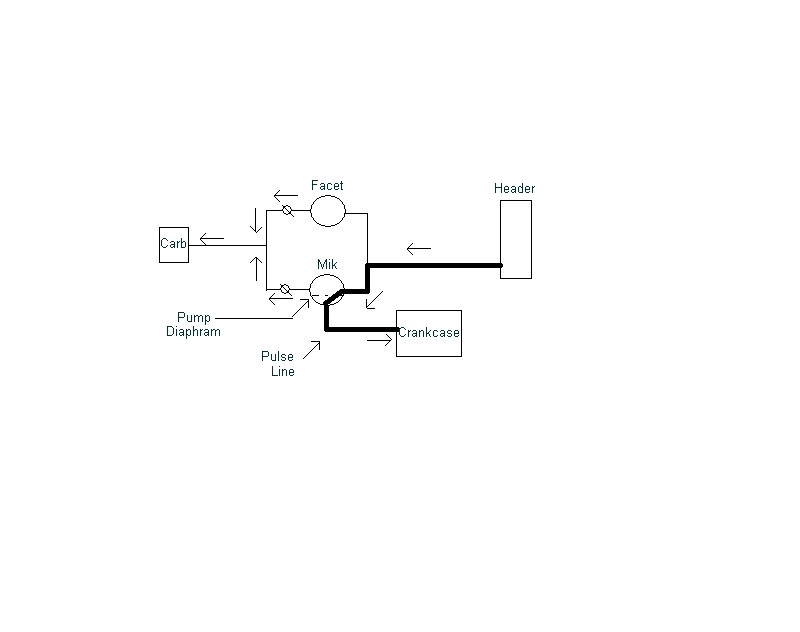

We had a discussion long time ago about the Facet Backup on a 582. About the only thing that can go wrong with the standard Rotax pulse pump is 1. The pulse line ruptures causing the pump to become inoperative. 2. The internal diagram of the pump ruptures causing the pump to stop pumping. In the case of #2, if you turn on the backup Facet, the fuel will be pumped into the Rotax pump and then through the ruptured diaphragm and into the crankcase. In this case, a backup will do you no good what-so-ever. In the case of #1, if you turn on the backup, the fuel will also be pumped out the ruptured pulse line and all over the engine. Still not good. Are there any new opinions on this possible situation?

One way valves ( out) on both pumps and then plumb them in parallel. Takes care of all the problems you stated.
Noel [quote]

See drawing if this is what you are saying about check valves on each pump. This might help in the case of a ruptured pulse line but would not do you any good with a ruptured diaphragm in the Mik pump. Follow the dark fuel line from the header to the crankcase. Raw fuel will pass straight to the crankcase with a ruptured Mik. You would have to isolate the input to the Mik but would probably be too late after discovery.

Once it's drawn up it is very easy to see the diaphragm leak you talk about. My experience is mostly with the diaphragm pumps on snowmobiles and on the older Tillitson carbs. I have seen some diaphragm perforations. What I have seen is basically the engine shuts down so there is very little fuel overflow into the crank case. I suspect that with a second fuel pump the amount of fuel leaking into the crank case will increase with the engine still running.
Two electric fuel pumps is no better.... A problem with the electrical buss could immediately shut down the engine.
