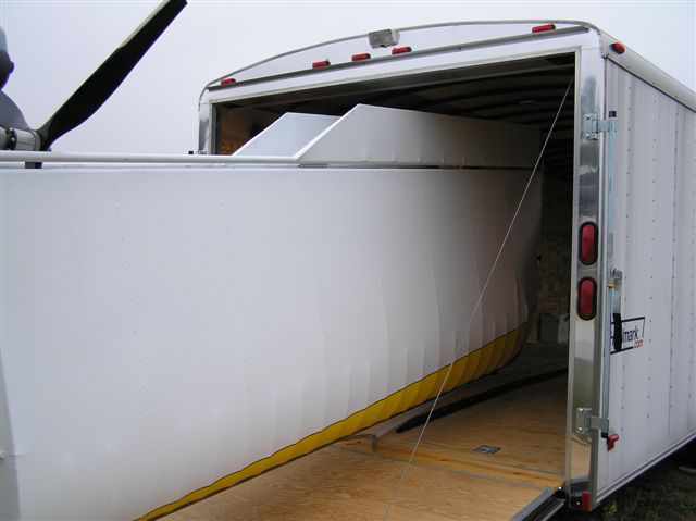

Attached image shows Chris Mallory's FS II w/3 blade composite going into the trailer. If using an enclosed trailer, clearance could be an issue. Even if enough, make sure top blades are even. Ask me how I know this.
