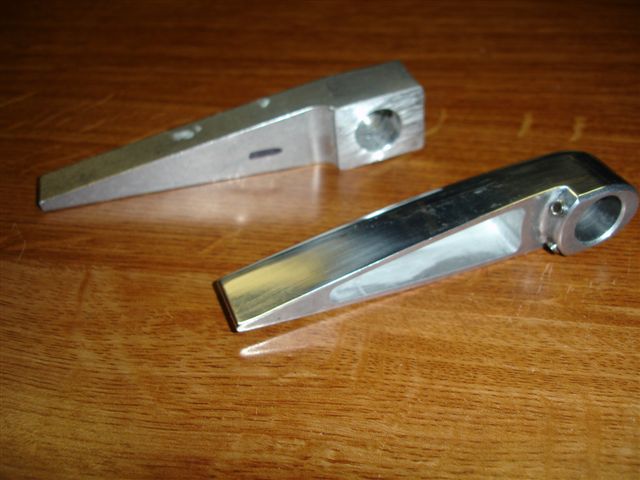

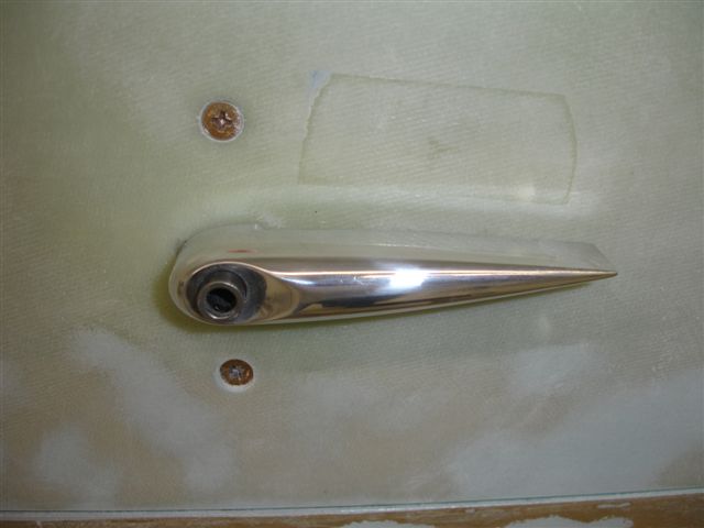

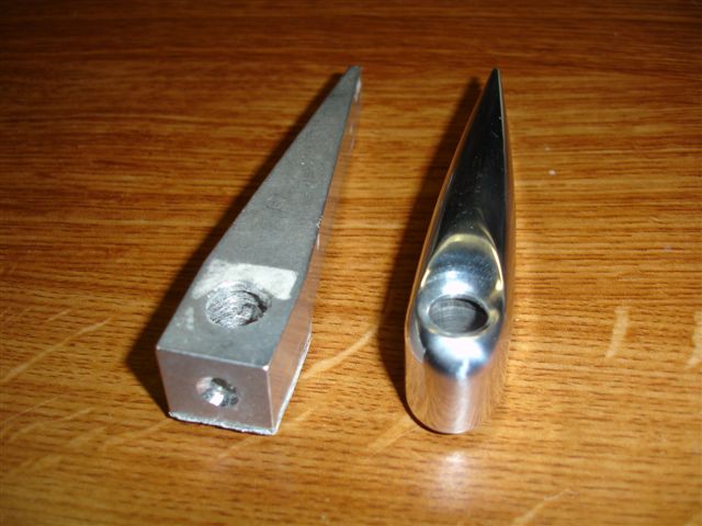

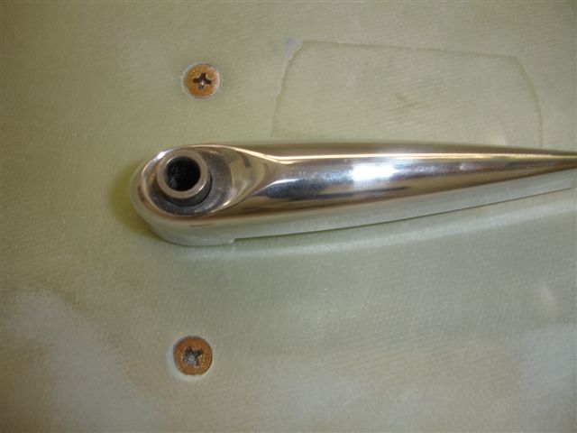

Dave just made a door handle for the RV10. It fits the existing RV10 handle assembly perfect. Like the other RV canopy handles he makes, it mounts with just 2 set screws. No need to put the large screw in the front.
We put this on tonight to check the fit. I already had the existing holes drilled for Vans handle. We slid the new handle on, torqued both set screws, removed the handle, center punched were the set screws made marks, and put the handle back on. The center punch makes little divots were the set screws go and this handle does not rotate. I tried pretty hard...but it doesn't rotate. Good to go.
Dave is making an aluminum insert that replaces Van's plastic cap. He says it will be a press fit. Just tap it in. I'll post a pic when I get it.
If you are interested in these handles, you can call Dave at 302-437-6087 or email him at his new email address.. dczachorowski(at)comcast.net
Check out the pics below...
