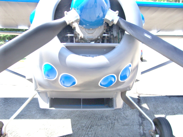

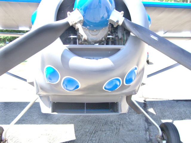

I fabricated an alum heat muff to fit around 1/2 the muffler which is held
in place with two large hose clamps. Air comes in (see bottom of cowl
opening in attached pic). A short piece of scat tubing connects back side
of cowl to the input of the heat muff. Another scat tube attaches from the
output of the heat muff to a cockpit controlled door on the firewall.
Don Smythe
