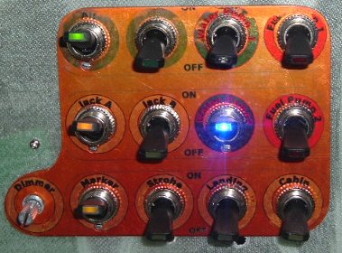

I compromised. Digikey has toggle switches with LEDs in the handles. I
used different colors for various items. Water pumps are blue. Fuel
pumps are red. Engine controls are green. All lighting is yellow.
They're all rated at 30A 12VDC, and cost right at $5 each...except for
the blue which I was surprised to find cost $9. (I didn't look that
closely until after I had the order placed).
I daisey chained them all the LED ground tabs together and brought a
single wire to an MPJA motor controller for dimming. They do dim, but I
would like quite a bit more range. I don't think I have the controller
calibrated correctly. The blues are harshly bright, but everything else
glows nice and softly.
This doesn't completely solve what you're looking for, but with an
intimate knowledge of the switch placement and color patterns, I think
it is an improvement.

In a message dated 12/07/2006 12:21:33 PM Central Standard Time, echristley(at)nc.rr.com writes:
HI Ed-
Used the same dimmer with similar rockers and had to add about 1000 ohm resistors (maybe 2000, IIRC) to choke down the blue LEDS. Resistors were added to the ground faston tabs on the switch for the LED ground.
