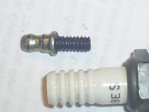

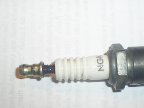

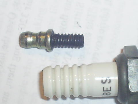

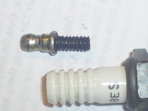

Hi All,
This is a solid tip plug that has been in use for over 50hrs. Note that the whole tip assembly was becoming unscrewed from the ceramic. I now check them every time I check/clean the plugs. In 150 hrs, this one was the worse, and I found one other loose, but still very intact. I did not notice any performance difference. Both of the plugs were on the same cylinder position (different times). I think that I might have contributed by "safety" wrapping the wire caps too tight.
larry

So much for solid tip plugs. I have been using plugs from the motorcycle shop and gaping them myself. So far no problems on 170 hrs
Travis
