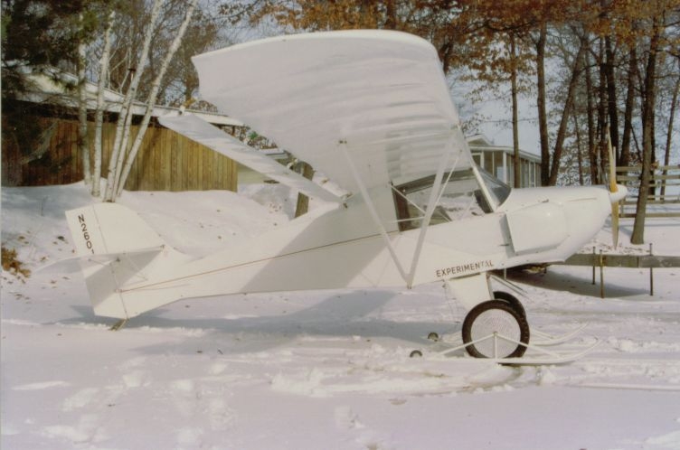

I'd like to get peoples opinions on skis for a Model IV. I know Skystar
offered them, but not (I don't think) in the wheel-penetration type
that I am interested in. We don't get enough snow around here (Lower
Michigan) to warrant full skis...that is, non-penetration skis. But if
we get our normal amount, my strip will be snowed over, while most of
the paved strips will be cleared of snow, and I wouldn't be able to go
there....well, you get the idea. I'd like to hear some dialogue about
what is involved in flying with skis, problems encountered, etc. I am
thinking of building my own skis of the wheel-penetration type, or
perhaps buying if a pair is available. I need a project, so building is
preferred.

Lynn, I ran my model 2 for a couple winters on the same tires (20s) that you
have and for up to six inches it was no problem. Heavy wet stuff may be a
bit different. If you decide to come up here and the snow is deep I'll plow
it for you! Actually, the skis are nice. The last two years I had my 2 I
ran it on skis that I made for it and I could go just about anywhere with
them, including paved runways. Up here, most airstrips have a place for
landing on skis, usually paralleling the active so there are lots of options
on skis, including the frozen lakes. Another thing about skis is that the
airplane tends to track straighter with less rudder input, and on a 2,
that's a big deal. Skis do make it a pain moving in and out of the hangar,
but there are ways around that. If just plan on hanging around "down south"
the fat tires will probably work for the most part. A good rule is to
always drag the landing area first to look for anything that may cause your
day to go bad.
Unfortunately, I let the skis go with the airplane when I sold it and now
the airplane is down in Mexico somewhere. I don't know what happened to the
skis. Should have kept 'em. They were one of my best productions.
Deke

PostPosted: Fri Dec 08, 2006 8:18 am    Post subject: Skis for Kitfox's Reply with quote
Lynn,
I've put almost 300 flying hours on a couple different sets of Avid's wheel
penetration skis and have to say ski flying is a blast, so don't shortchange
yourself by not doing it. And the wheel penetration ski works great. I
would never want to go back to a straight ski.
I sent you a short video showing the wheel penetration skis in operation on
my early Avid Flyer in a separate e-mail. Or for anyone else wanting to see
it just click onto the kitfox lazair videos at
http://www.lazair.com/kitfox/movies/ and choose the video titled
avicAskis.mpg. (or if you want to go direct, just click on
http://www.lazair.com/kitfox/movies/avicAskis.mpg, but then you'll miss all
the other great videos on that site).
Ski flying with wheel skis can only be compared to having a seaplane with
amphibious capability - the options of taking off at the airport and then
landing in snow (or water in the case of the seaplane) provides one with
significantly enhanced experiences. Knowing you can now go pretty much
anywhere you want is a real rush. It opens up so many opportunites to visit
places that were previously off limits to you. And from a safety
perspective, it significantly increases your places to land in the case of
an emergency. The fact that you won't have the hassle of dollying your
aircraft from the hangar to a snow runway, or that you won't have to worry
about either too much or too little snow (knowing you can always operate off
the asphalt) makes the wheel ski a pretty good thing to have for winter
flying enjoyment. You will also find snow operations easier than pavement,
as the aircraft tracks straighter with the skis, and runway lengths or
direction are generally less limited. When you do a good snow landing it is
much like flying floats, you won't even know you are on the surface until
you either hit a small bump or see a spray coming off the undercarriage.
I'm not sure that flying can get any better than that...
The downside? Well, there are definitely some issues with ski flying. I
personally believe ski flying has a tremendous possibility of messing up
your airplane. Remember, most aircraft get wrecked off airport. And in the
case of skis, because you can go pretty much anywhere, you tend to do so.
And to make matters worse, the place you are going to land on is most likely
covered with a nice smooth layer of snow. It will probably look gorgeous
from the air. Smooth and bump free. But hidden underneath all that smooth
snow can be boulders, ridges, fence wire, ice chunks, etc, etc. Adding
insult to injury is the fact that you can't see very well as you are truly
experiencing the effect of being snow blinded. Flying low over a snow
covered area before you land looking for obstructions is always advised, but
many times won't really show you anything except a lot of white. Snow
drifts, ridges, and shallow drop offs are hazards that are some of the
hardest to see, many times being impossible to distinguish from the flat
areas. The 7,000 acre lake I live on here in Wisconsin makes for a great
winter runway (that's where the video was shot). But because we have a lot
of snowmobilers making ruts, and ice fisherman drilling holes (with nice
hard elevated rings of ice around the opening) all over the place, you have
to be careful. I'll admit to hitting many an ice fishing holes, and landing
cross ways on hardened and rough snowmobile trails, in my hours of ski
flying. That isn't exactly the fun part I described earlier. It will make
you wonder how much of that abuse your skis and/or your plane will handle
before breaking something. But if you are careful, and get those days when
you are the only one out in the fresh powder, it will make all other winter
snow related activities boring by comparison.
Here's a cute little wheel ski story I have to tell; One year I was lazier
than usual and left my wheel penetration skis on my Avid until mid July. I
thought it was kind of funny to do it, and what the heck, the airplane
operated just the same. But I decided that I had one last thing to do
before removing them..... So I loaded up my sheepskin lined leather winter
parka, along with my heaviest mittens and fur hat. Then I flew the little
Avid to a small airport I had never been to before. Once there I pulled up
at the fuel pump to top off my fuel (all of about 4 gallons as I recall).
When the line boy came out he was totally confused by seeing skis on my
plane. He asked where I had come from? I told him the mountains north of
the Yukon territories. Trying to keep from laughing, I told him I was glad
all the snow and ice had finally melted off the plane, and then went on and
on about how nice the weather was here in Wisconsin. Intrigued, he started
asking a lot of questions about range, speed, carrying capacity, etc of my
little white Avid Flyer. Then he wanted to know how it is that I could sit
that long in that small cabin? Somehow or other I muttered out answers
without laughing. Finally we went into the FBO so I could pay for the fuel,
and the next thing I know he has all of his coworkers coming out to see
"this neat little plane that flew here from somewhere near the north pole!".
Trying to avoid a lot of embarassment, or possibly being strung up by the
line boy, I told them all the truth, and then apologized for stringing them
along. They were a great bunch as they all got a good laugh from it.
Flying home that day I knew it would be a day I'd remember for a long time.
So there's proof wheel penetration skis aren't just for winter anymore<GRIN>
If you live where there's snow, go out and enjoy some ski flying. You'll
never regret it. If you don't get any snow, well you might want to consider
moving where there is...
Paul Seehafer
Central Wisconsin
ps - attached is a picture of my early Avid on wheel skis with the large
skinny tires. My later Avid uses the standard Avid/Kitfox type tundra tire.
Both tires worked well, with the advantage going to the narrow and tall tire
due to providing more ski area when in deep snow.
 Filesize:  160.57 KB
 Viewed:  451 Time(s)
