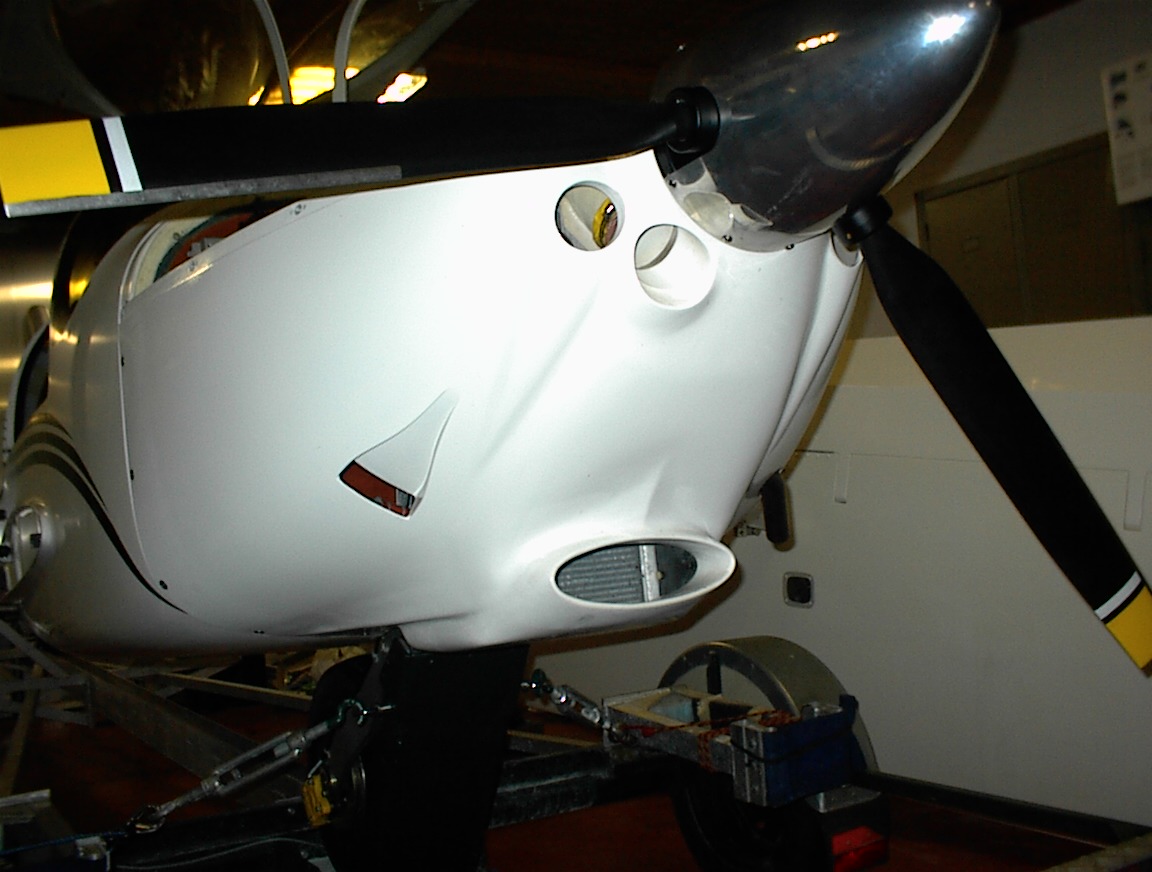

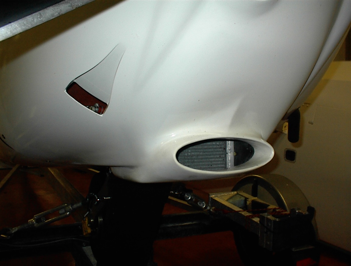

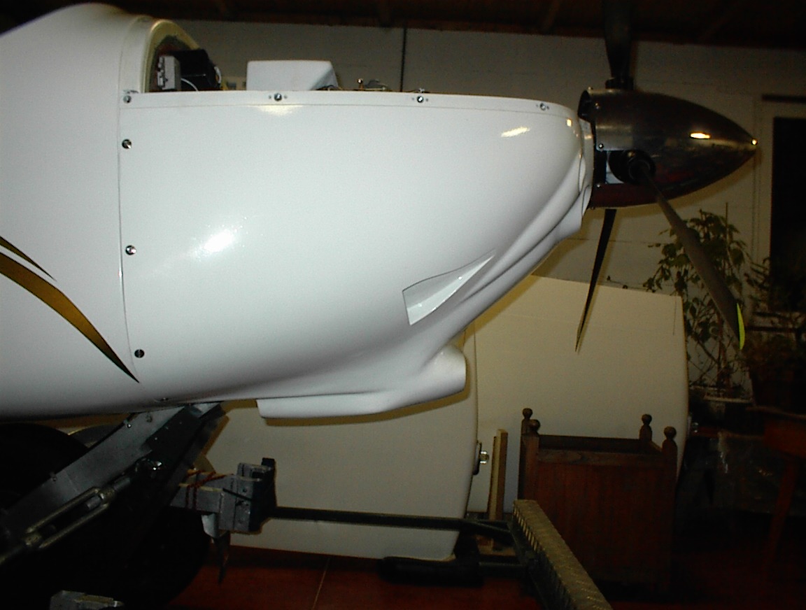

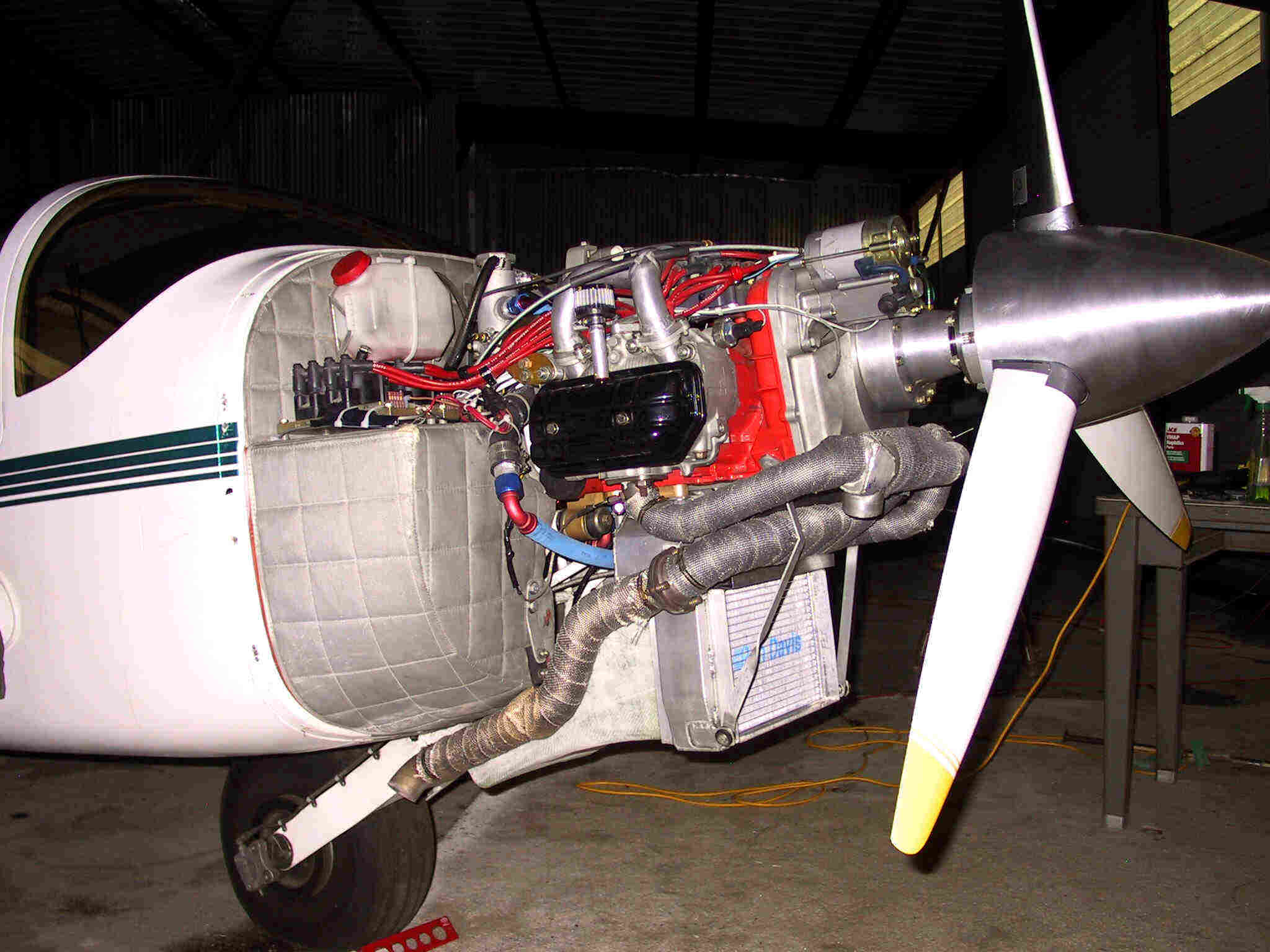

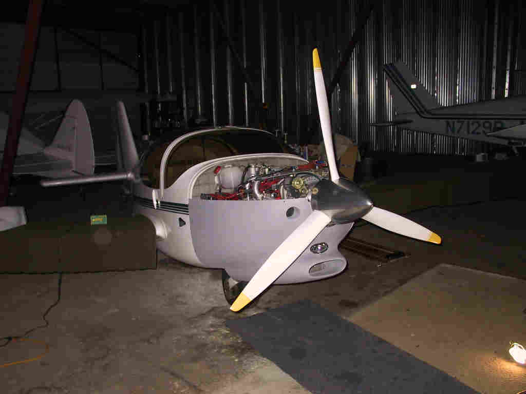

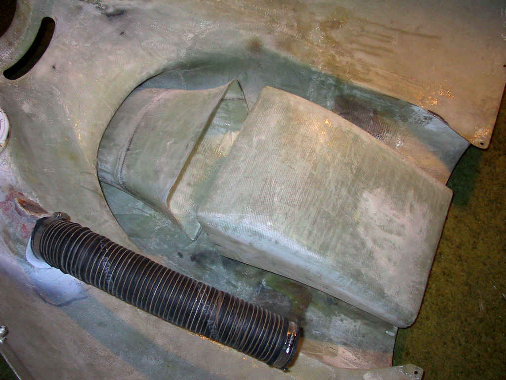

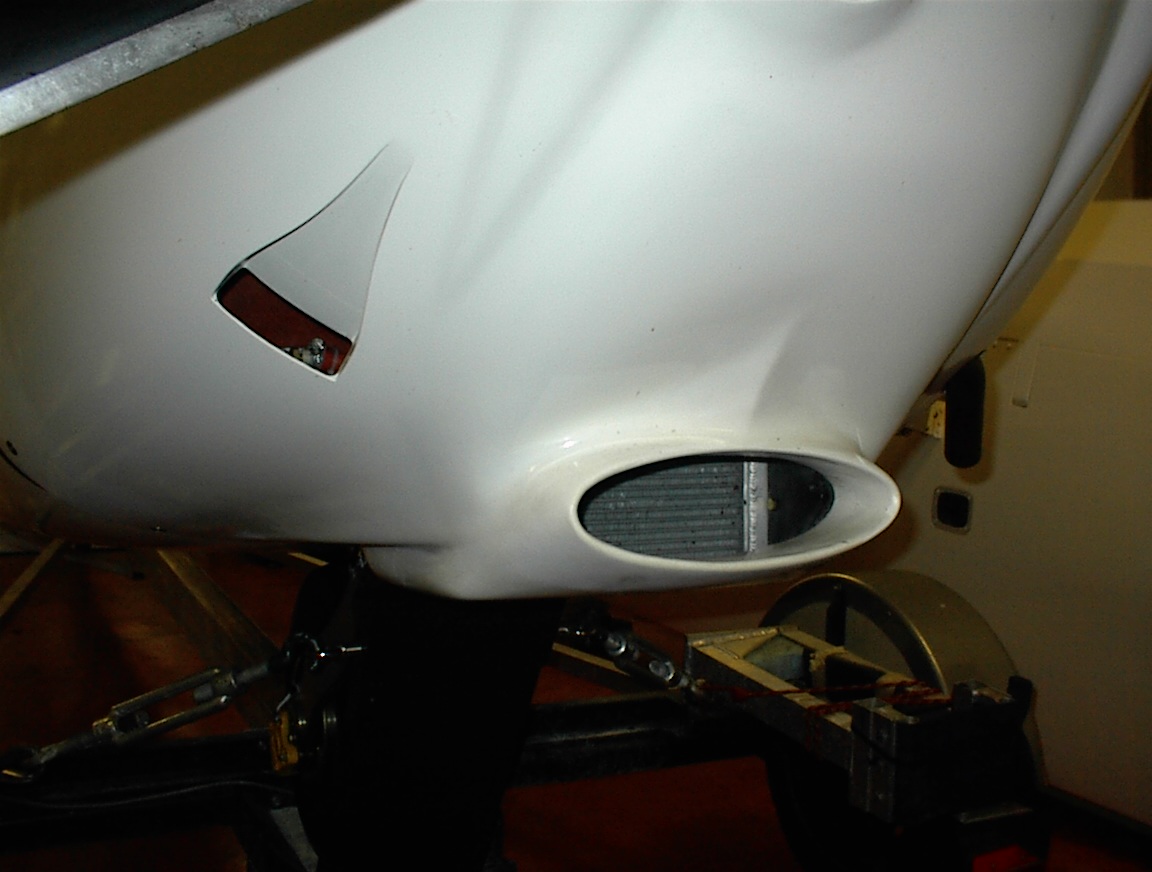

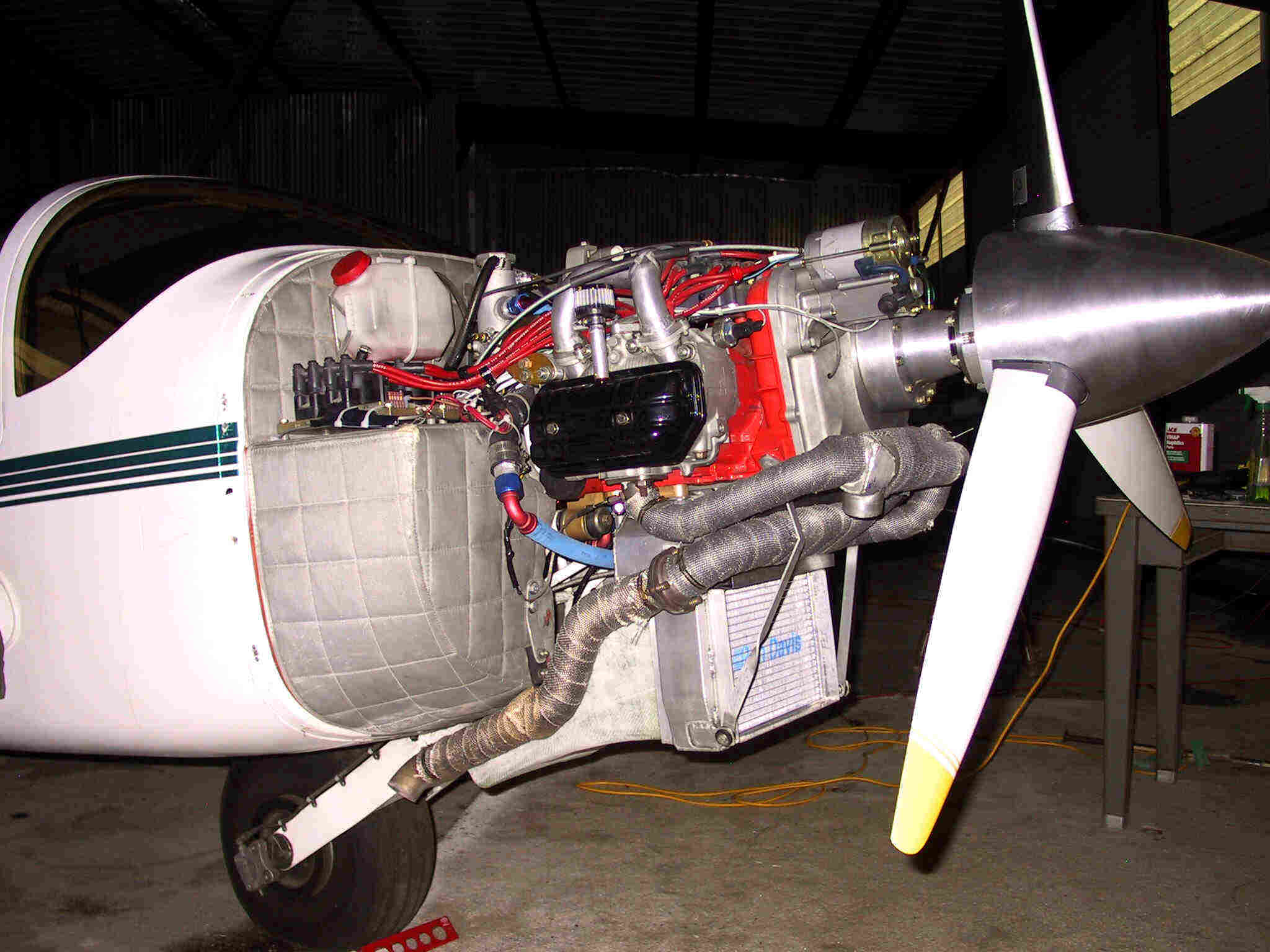

I created an almost exact copy of the Kuchemann/Weber perfect
diffuser on my Europa to try and keep my 135 hp EA81 cool.
All cooling on the EA81 is thru the water jacket and none is done by air
cooling on the 912/914 so the ducting has to be good.
Both cooling in the air and ground are very good. I can run the
engine as long as desired at 1800 rpm on the ground without over
heating even on a 100 F day. In the air, water temps to go 200 F
after a 2 minute climbout then drop back to 185 for cruise.

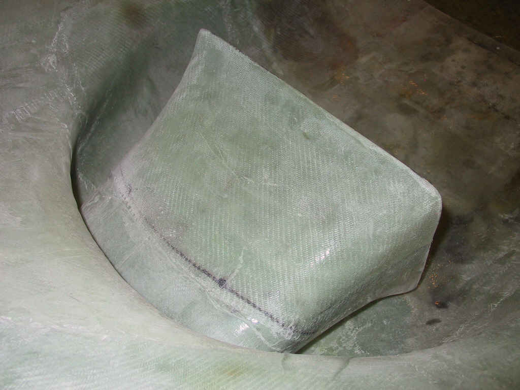

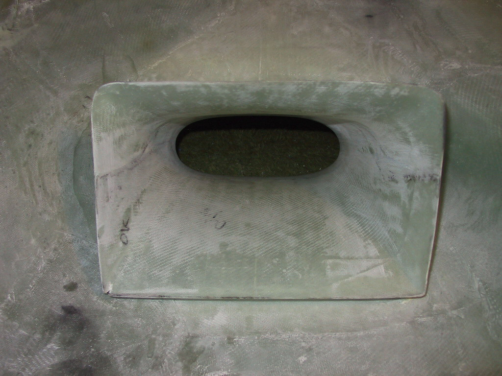

There is a 12" long diffuser section that expands like a bell to
slow and pressurize the incoming air. After the rad, there is a
converging duct that accelerates the hot air back to free stream.
There also is a pull up cowl flap inside the converging section
that allows most of the incoming air to be shut off under cruise
conditions, adding 10 mph by cutting the flow and associated
drag when its not needed. Works great!

PostPosted: Fri Dec 01, 2006 3:18 pm    Post subject: Perfect cooling diffuser Reply with quote
Glenn,
This is the way to go.
Nice work designing and constructing your cooling duct and cowl flap.
Küchemann is indeed a excellent basis to start from.
We had long discussions with Michel Colomban, of Cri-Cri and Ban Bi
fame, who also used calculated sections similar to Küchemann's
theoretical curves.
Since I had the opportunity to build a small wind-tunnel, I chose to use
the stream-line approach (also in Küchemann's book), to exactly match
our radiator block characteristics.
The results showed that a shorter -hence less lossy- diffuser was
adequate in our case.
We also had to manage cylinder cooling air and intercooler duct.
Your cowling looks very sexy.
Congratulations,
Gilles Thesee

Glenn
Which Subaru conversion did you use, the weak link often seems to be the
reduction drive.
Graham

Hi Graham!
I used the Marcotte M150 drive made in Canada. Its been very good so far.
http://www.geocities.com/rayfiset/psru.html
More info here:
http://www.sdsefi.com/air14.html
The engine was built by Ram Performance Subaru in Dayton Ohio
http://www.ramengines.com
He has a new 200 hp Supercharged EA81 with Rotrex supercharger on his site
now.
I don't know of any unhappy users at this time!
Glenn

PostPosted: Sat Dec 02, 2006 12:25 am    Post subject: Perfect cooling diffuser Reply with quote
Glen,
What is your ratio(s) of inlet area to outlet area?
I realise that it is adjustable.
Duncan Mcf.
Gilles.Thesee(at)ac-greno
PostPosted: Sat Dec 02, 2006 5:20 am    Post subject: Perfect cooling diffuser Reply with quote
Duncan,
What really matters is the ration of outlet area to RADIATOR area. As
already stated on Contrails, too large an opening won't flow more air
than a correctly proportioned one, since it is the radiator that governs
the flow in the duct.
It may help to figure the radiator duct system as a duct with 3 valves
in series. The middle valve is the radiator. As it is partly closed,
opening the other valves more than necessary won't change the overall
throughput.
There is no use opening the outlet more than about 1 time the radiator
frontal area, you would only add drag without increasing air flow
through the radiator. Drag decreases as you reduce outlet area by means
of the cowl flap. In cruise, outlet area should be smaller than the
inlet area to achieve minimum drag. It is advisable to construct the
adjustable cowl flap with a range of openings from 1 time the radiator
area to near zero (power descent on a cold day).
In our setup, inlet area is 25% of the radiator frontal area, whereas
exit cowl flaps can be adjusted from 70% to 0% of the radiator area (410
cm²). We currently cruise with flaps adjusted to 18% of the radiator
area, or less on cold days. On summer hot days, best cruise (75% power)
is with the exit adjusted at about 28% radiator area. Of course we open
more in a prolonged climb.
During flight tests I installed a data logging system to check adequacy
of the pressures and temperatures.
Adjusting CHT and oil temps to within 5°C of desired temperatures is a
breeze, and we found no special limitations concerning ground run time.
A thorough cooling study is really worth the time and hassle.
Hope this helps,
Gilles

PostPosted: Sat Dec 02, 2006 10:03 am    Post subject: Perfect cooling diffuser Reply with quote
Hi Duncan!
The rad face area is 9x12" so 108 sq in. Inlet area is 34 sq in so ratio
.31. Outlet area is
4 x 12" so 48 sq in so ratio .44.
The idea behind the bell shape is as the air enters the duct and begins to
slow down,
it can follow a tighter radius without separating. When the air enters the
rad, it is
straightened again and then accelerated back to free stream in the
converging duct.
I think I still have some excess cooling capacity so I think this rad/duct
combo is probably
good for 150 hp. The guy in San Diego building the 200 hp supercharged
Europa is pretty much copying my cooling system so it will be interesting!
I have a 2
row dual pass aluminum rad on my setup. I suggested going to a 3 row dual
pass brass for his
supercharged setup.
Glenn

PostPosted: Sun Dec 03, 2006 1:11 pm    Post subject: Perfect cooling diffuser Reply with quote
Gilles, Glenn and all,
Here some pictures of my cowl modification; indeed inspired by Mustang P 51.
Karel Vranken.
 Filesize:  169.01 KB
 Viewed:  249 Time(s)
 Filesize:  163.01 KB
 Viewed:  248 Time(s)
 Filesize:  171.01 KB
 Viewed:  233 Time(s)
gcrowder2
Posts: 136
Location: Golden, Colorado USA
PostPosted: Sun Dec 03, 2006 5:50 pm    Post subject: Perfect cooling diffuser Reply with quote
That looks awesome Karel!
Be sure to seal off all around the duct inside so incoming air can only
go thru the rad.
Managing air flow is like herding cats - if theres a way not to cooperate,
they will
find it! On my rad, I welded on aluminum angles all the way around the face
of the rad
making a fence about an inch tall to allow the duct to slip inside. No
funky seals to monkey with!
Glenn

PostPosted: Mon Dec 04, 2006 1:16 pm    Post subject: Perfect cooling diffuser Reply with quote
Glenn,
The duct inside isn't part of the cowling. I made it of carbon tissu, it
looks like a black hole, but be sure it is perfectly sealed on the radiator.
The radiator also is modified, no more the square block but a 4 cm thick one
of 26 cm x 15 cm = 390 cm2.
Karel Vranken.
