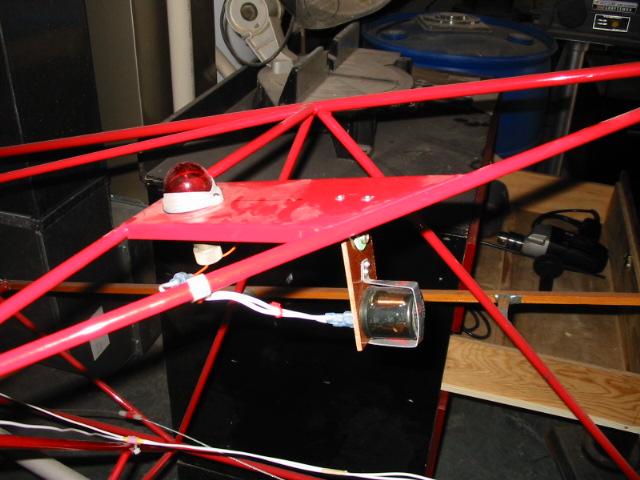

Has anyone found or know of a low profile beacon that could be fit to the top of the vertical Stab? What are others doing for this? I have a 912s, so the Amp draw needs to be kept low.

I made mine out of a tail light assembly with a wing tip lens and a heavy-duty turn signal flasher.

Thanks for the idea. I just can't stand the thought of paying Whellen $300 for a friken lightbulb. I found a source for high intensity LED's and plan to see what I can develop.

Dan go to Chief Aircraft or Aircraft Spruce. There are self contained
beacons for 50- 125.00. I found one on fleabay and mounted it on my
vertical stab. I used a plastic funnel cut to fit down over the stab, then
poured full of epoxy and chopped glass for a nice fairing/ mount. The low
profile thing is hard to achieve without needing a belly mount also. Ron NB

I had the same feeling and gutted the fixture and made a micarda insert that holds a 20 watt halogen bulb from the auto parts store ($1.50). The actual wheelen parts came from a junk pile at the local shop. LED’s would work great inside this type of fixture as they do not but out as much heat. Where are you getting your LED’s and how big are they?

I went with the LEDs and constructed "bulbs" which fit into the
unmodified Whelen sockets. Sources, pictures, and specifics are
on my web site (about halfway down the page) at:
www.itsys3.com/kitfox/discover.shtml

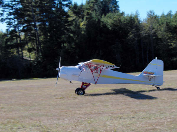

Ron, as much as I tried, I can't get my feeble brain to visualize what you
described for a mounting. Can you try it from a different angle?
Deke

Deke I'll post an after picture. The funnel sits pointing downward as if in
use. the flat top is where the base of the light attaches. The spout and
part of the sides get cut off to form a channel which drops over the
vertical stab. Place plastic barrier over stab, then place funnel over,
then fill with epoxy. Remove, sand paint, walla. Sorry I don't have a
close up, but it flares to a flat spot like a Cessna. Ron NB Ore

Thanks Ron. I understand now.
