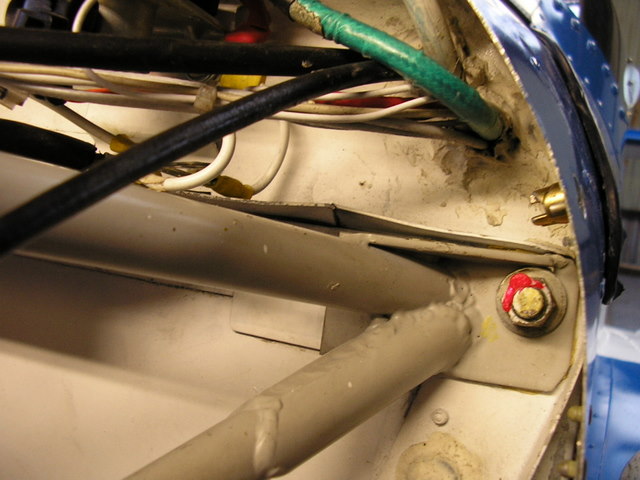

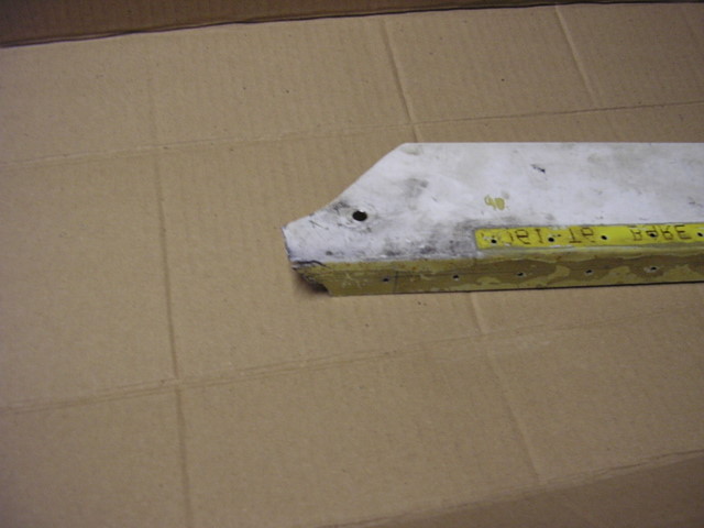

Hi list we have found a crack in the firewall stiffner near the port engine mount and have had to replace the stiffner
We beleave this may be because we are using a Continental 0-200 & a header tank so are on a fairley forward C of G. Have any of you with this combination had any problems ?
We have difficulty in Just lowering the nose on landing, it tends to want to drop when you remove the power. It is possably caused because to much we trimmed off the stiffner to fit the original faulty engine mount.
We found this when changing the nose wheel bungey which was fraid at the bottom tube and started to shed rubber.
We have done a lot of tuch & goes try to perfect our landings
  Clive Richards
GCBDG 52 Hrs Estimated 250 T&G / Landings

Any way we can get a photo of the crack? I'd like to make sure I know exactly where it is developing.

s.c.richards(at)homecall.
PostPosted: Fri Dec 01, 2006 2:05 pm    Post subject: Crack in 601HD firewall stiffner 6F8-2 Reply with quote
Gig
Photos attached as requested showing position of crack & cracked end with
stiffener removed. The piece which broke off is not to hand.
We have replaced stiffener but left end wider over engine mount and taken
strengthening angle above across full width of fire wall.
Clive

PostPosted: Fri Dec 01, 2006 2:30 pm    Post subject: Re: Crack in 601HD firewall stiffner 6F8-2 Reply with quote
Thanks for the photos. The earlier poster was right the XL has beefed that area up some But it will go on my list of places to watch anyway.
