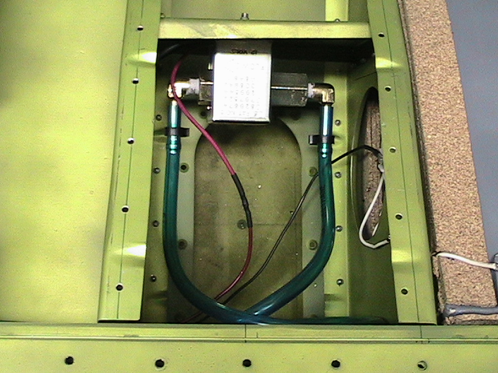

PostPosted: Sun Nov 26, 2006 6:37 pm    Post subject: Fuel Pump Placement and Fuel Line Question Reply with quote
I made a pair of mounting brackets that are rivetted to NR2 and NR3. The brackets support the 40501 fuel pump in each wing. The bracket and pump are displaced forward of the oval access hatch in the bottom of the leading edge skin. The pumps are secured to the brackets by two AN3 bolts (each) that engage rivetted platenuts. The access hatch allows inspection and maintenance of the finger screens, the barbed hose fittings, clamps, the unjustly maligned Bing fuel line, the pump, its wiring etc. The pump can be removed and replaced as needed through the access hatch without attacking the leading edge skin itself. In other words, I'm not sure why a wing mounted pump would have to be placed anywhere else. This seems like the obvious best place to me. I have photos if you are interested.. contact me off list,

lwhitlow
Joined: 15 Jan 2006
Posts: 76
Location: Valparaiso Indiana
PostPosted: Sun Nov 26, 2006 7:07 pm    Post subject: Re: Fuel Pump Placement and Fuel Line Question Reply with quote
HI Ed
Pics would be great!! Maybe I have fat hands but I can't see how I coud get the pump loose and out of the access port. Even if i had a threaded mount for the pump getting a tool in there and holding the pump seems to be tough. Plus the associated fuel lines would take up some space
I would love to see your install and how you solved the problem. Why not post a pic here so we all can see?

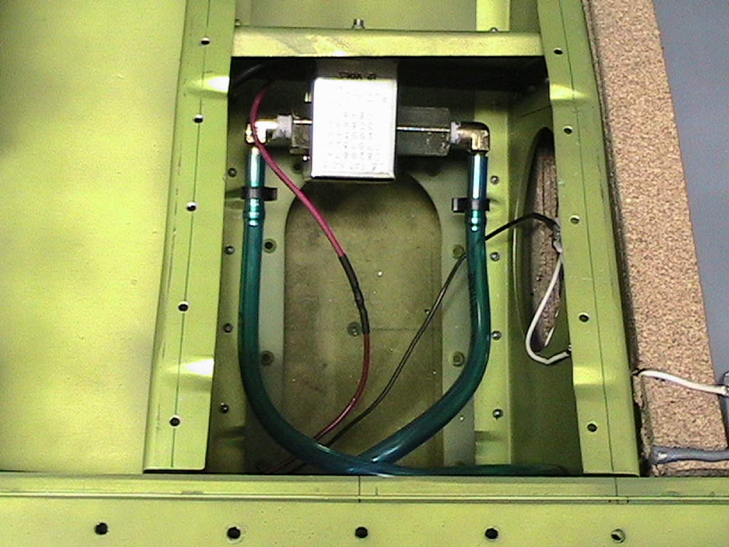

PostPosted: Sun Nov 26, 2006 7:52 pm    Post subject: Fuel Pump Placement and Fuel Line Question Reply with quote
I'm a dentist and small work spaces are not scary to me but this one is really no sweat. I did make the access port as big as the space would allow but that is not much bigger than what was called for in the plans. A small ratchet handle, a short extention and a short socket do the job of installation / removal with reasoanble ease. Beats a root canal on an upper second molar anyway.
Ed
Don't bother flaming me on the Bing fuel line... that's what I'm using.

PostPosted: Sun Nov 26, 2006 8:46 pm    Post subject: Fuel Pump Placement and Fuel Line Question Reply with quote
But it looks like you are using crimped clamps which is good Smile
-- Craig
