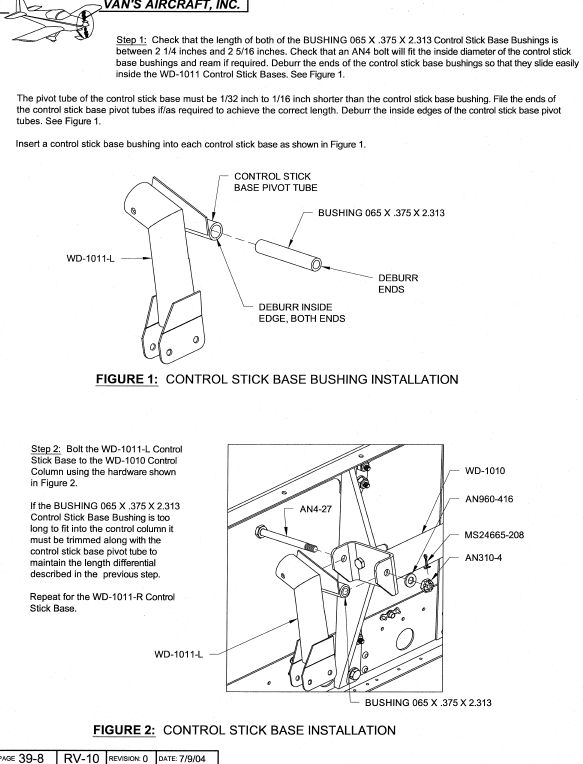

The source of the slop in my case was actually the OD of the
BUSHING 065 x .375 x 2.313 shown on page 39-8. (see attached
.jpg)
Or more accurately, the sloppy hole in my WD-1011-L & R.

I fixed it by using a loctite product "Loctite quick metal
660" that I had sitting around from a previous bushing
repair a couple years ago.
http://www.chemicalcontacts.co.za/teroson/retainers.htm
You could probably use many of the ones on this page.
Basically, it just fills the gap and solidifies the
bushing to the WD-1011, so it now pivots on the nicely
fit bolt. When tightening the AN4-27, you just bring it
up tight, then loosen it to the next castle, so it's
not sloppy, but non-restrictive. Wala, no more stick slop.

PostPosted: Mon Nov 20, 2006 10:57 am    Post subject: Control Stick Engagement into Control Stick Base. Reply with quote
By reading the page you sent (and according to our installation), it seems
to me that the bushing is supposed to be tightened with the bolt (so it is
fixed with the bolt), then the WD-1011 is pivoting on the bushing, not the
bushing pivoting on the bolt. Am I way off here. I would think the allow
the bolt to be loose would be less safe than greasing the mate that you
glued so the pivot is there. I think that's why it says, "Debur the ends of
the control stick base bushing so that they slide easily inside the
WD-1011..." Either way there are parts rubbing, but that would certainly
explain why the bushing needs to be longer than the WD-1011.
Am I way off? I am sure it will work either way, but to fix wobble in ours
I turned down the end of the bushing so there is no play on the WD-1011.
Well, anyway, wobble is bad if you can help it. At least it is
disconcerting when you are flying autopilot and you touch the stick and it
feels loose. Going with the dremel sanding drum either on a dremel or a die
grinder will do the trick. It should also help with the clearance with the
instrument panel, I would think, making sure the engagement is sufficient.

In most mechanical systems, the bushing is meant to move around on
the removable hardware...the bolt. As you noticed, that's why you want
to ensure the bushing is longer than the other part, so the
steel-to-steel is eliminated at the ends. Also, with slop if that
bushing wasn't secured, that outer part could slide back and forth
and still rub on the other steel part....not good. With the bushing
captive in the WD-1011, you're now limited to brass-on-steel movement,
with the endcaps from the other steel part only rubbing brass.
You'll still need to deburr the ends, because you want to be able to
easily slide the brass tube inside the steel....but deburring isn't
going to have any effect, even if you put it together the other
way, on any wear inside. Now, if you do capture that bushing inside
the WD-1011, you will certainly not want to crank way down on the
pinching bolt, or you'll induce a lot more friction into the system.
I should note that ideally, you should not have to use loctite or
anything on the WD-1011. Ideally it would be a high-friction
almost press-fit. But, there was so much slop in there that I
had no choice but to use a gap filler. I had considered
having a larger OD bushing made up that was a tight fit, but
that just wastes time and money and effort. You really don't
want the thing revolving around inside the WD-1011 anyway.
But, if you didn't have much slop, it really wouldn't be a huge
problem, either. At least it isn't steel-on-steel...except if
the steel ends of the WD-1011 start to contact the other steel
control linkage.
The fact that it's a castle nut spec'd there also indicates
that it isn't necessarily a high-torque application. Just like
doing wheel bearings, snug, then back off so they spin freely,
and use a cotter pin. Nobody questions the safety of a wheel
that spins freely and the nut is held by a cotter pin, right?

about 100 hours ago I noticed it one smooth flight, and got
paranoid about the wobble. I inspected the linkages and didn't
see any issues, so decided to put it on the list to dig
into at a convenient time. When Vic flew it and noticed the
slop was worse than his, it got moved higher on the list,
so now it's done. It now is completely slop free, and the
controls are still smooth and light. Everything's very good,
and I know the steel parts are rubbing down there. It's
the little things that bring a smile sometimes. Wink

I may be wrong but I think the bushing was designed to be captive. They
purposefully made it longer than the weld mount to tighten under the bolt. I
have the same slop, but I'm just replacing the weld mount, being careful to
maintain a tight press fit between the sick and bushing.....

PostPosted: Wed Nov 22, 2006 9:16 am    Post subject: Control Stick Engagement into Control Stick Base. Reply with quote
Thanks for all the replies on this. I sent the question to Vans and got a reply from Ken Scott.
He said
 "The stick should bottom out in the base...which would be about the weld line."
Niko
