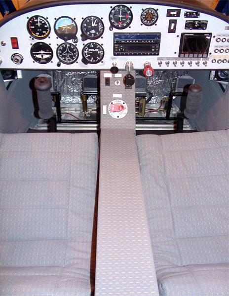

I placed the fresh air outlets on my panel using eyeball vents with adapters
(from Aircraft Spruce) to pick up SCAT tubing from the NACA outlets placed
in the dwg location. No problem, except vents use up panel space. See
http://www.zenithair.com/zodiac/6-photo79.html picture
http://www.zenithair.com/zodiac/pic05/493tg3.jpg
The headset jack locations below the panel in the corners directly below the
vents can sometimes be a problem. I relocated the pickups further forward
for a little more room.
Tony Graziano
601XL/Jab3300; N493TG, 173 hrs

PostPosted: Mon Nov 20, 2006 8:15 am    Post subject: Fresh Air Reply with quote
Love your seats!
www.zenithair.com/zodiac/pic05/493tg4.jpg
How do you like your Trio AP?
-- Craig
