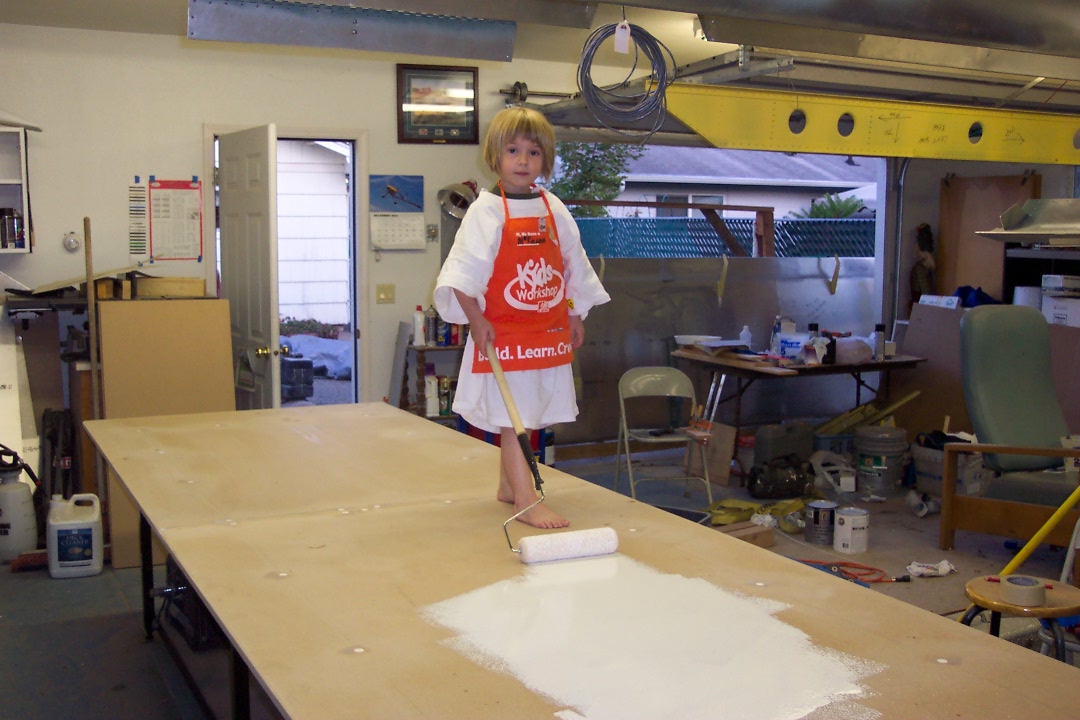

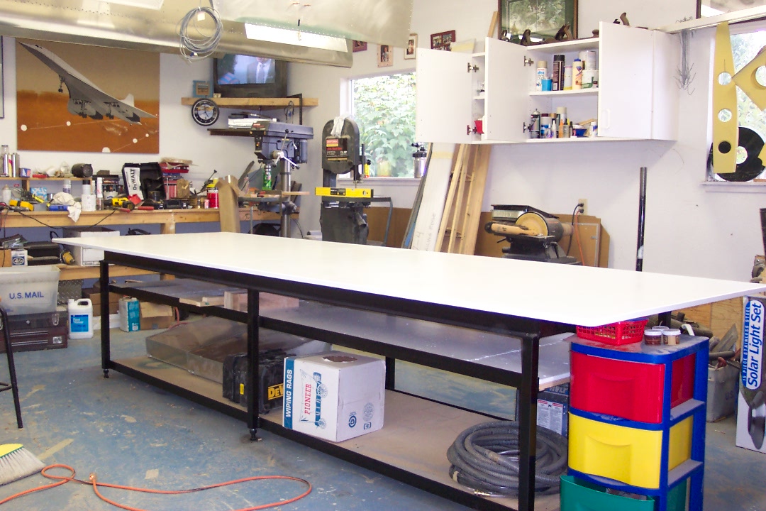

My bench is 3' X10'. The top is made out of 4" channel iron. It has 6 legs.
I put 2 levels of angle iron below the top. Welded nuts on the bottom of the
legs for adjustment. So, I actually have a 4 X 10 top plus the lower shelves
for storage and tools and stuff. It's probably overkill, but it doesn't move
and it is perfectly level all around. It also weighs about a ton, but it
doesn't budge. I suppose you could put casters on and level it whenever you
move it. Hope the pictures aren't to big.

I used MDF for my top also. Just painted with a couple coats of semi gloss latex I found in one of my trucks. I don't think it matters what you use. You don't even have to paint. It makes it easier to lay out lines if you want and also to find little things you might have dropped on it.

Actually, my table top is 4X12. 14 ft long would be nice, but I don't have
the room. I like your idea about the trailer jacks. I might have to do that
if I need to move it. It takes 4 people to do that with the top on and all
the steel in it. That way it could be moved without unloading all the stuff
on it first.

Looks like you could build half a plane in the time it takes just to get your shop ready. Lots of work. I would probably die of altitude sickness at your house. It's about 200' MSL around here.
Dave in Salem

I don't have wheels but I did follow these plans and have a flat strong table 12' long & 4' wide. I have scratch built the tail feathers, flaps ailerons and wing spars on it. The rivets were set using a hammer on the table and a one ton arbor press. The table did move 4" during the riveting but when put back in place it is still flat and strong.
Here is the link to the table plans:
http://www.ch601.org/tools/Visio-12%20foot%20work%20table.pdf
I did follow the plans with one deviation, I used a joiner to plane the 12' and 4' beams after they were assembled.
Recommended
