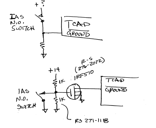

PostPosted: Sat Nov 11, 2006 9:14 pm    Post subject: Transistorture Reply with quote
Bob,
I would like to use a transistor to convert a normally open switch to
normally closed. I need to switch a circut ground off. This would be very
simple with a relay, but, I would like to use a transistor if this can be
done. Is this a reasonable approach? If yes can you draw me a diagrtam?
Thanks.
nuckollsr(at)cox.net
PostPosted: Mon Nov 13, 2006 5:41 am    Post subject: Transistorture Reply with quote
At 09:14 PM 11/11/2006 -0800, you wrote:
Bob,
Thanks.
Can you sketch the surrounding circuitry? Do you have access to
both ends of "the switch" or is one end already connected to
ground . . . or perhaps 12v? What do you what the output to control?
dsvs(at)ca.rr.com
PostPosted: Mon Nov 13, 2006 9:40 am    Post subject: Transistorture Reply with quote
The circuit is just a ground to tell my TCAD that it is on the ground. A
pressure switch ( I can only find NO in the range I need) is in the pitot
system. The switch closes at roughly 50 knots. I have access to both ends
of the switch. The switch is a micro pneumatic logic 503. Maybe you know a
supplier that would sell me one that is NC.The closing of the switch is
supposed to open the ground on the TCAD. I can easily convert the no to nc
by using a relay, but, I thought a transistor may also work?? Just making
an attempt to learn more electric stuff. I hope that this explanation
works.
PostPosted: Wed Nov 15, 2006 6:32 am    Post subject: Transistorture Reply with quote
works.
If we knew more about the internal wiring of the TCAD system, perhaps
the solution could be as simple as the first sketch below.
However, the second sketch is 99.9% certain to work. All the parts are
available from Radio Shack.
