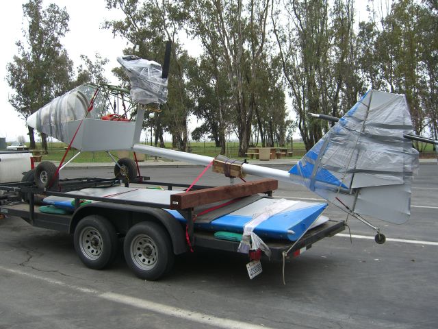

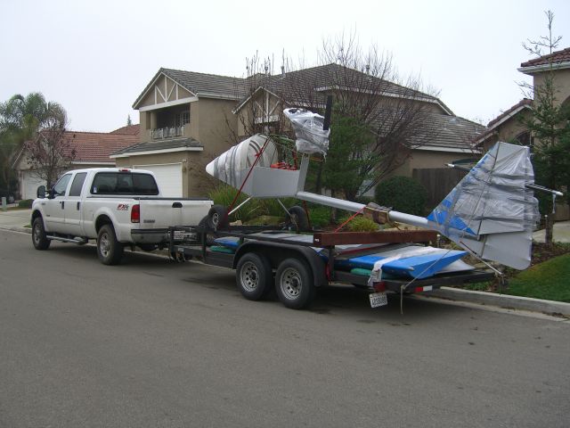

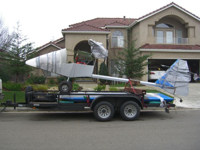

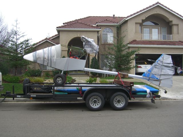

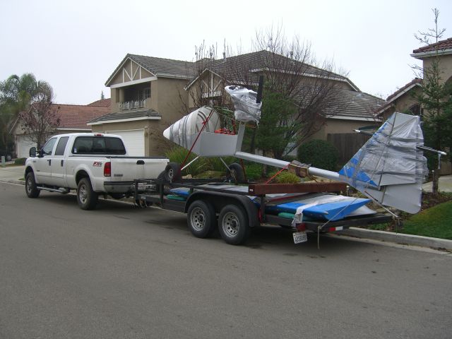

Firebug, this is how I hauled mine for 700+ miles through rain, snow, ice,
fog, etc... Absolutely no damage...
DVD

PostPosted: Fri Jan 27, 2006 8:58 am    Post subject: Re: I may have to trailer a KOLB and have questions Reply with quote
DVD
Hmmm... Pictures didn't come through... I give up, how do I add pictures?...
DVD
