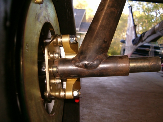

Hello list,
I was wondering if anyone has any experience or suggestions for cutting the hardened steel axles? I want to trim off about 1 1/2" that sticks out the inside of the axle sockets. It is serving no real purpose and is dead weight. It is also something to just snag on something in the event of a less than optimum landing surface.
I know from drilling, this stuff is hard. Not sure if I can cut it with portable bandsaw that I use for just about everything else. Don't want to try something that will just scar the axle up.
Thanks for any help.

Air powered die grinder with a cutoff disc on it. -sometimes called
an exhaust cutoff tool. Check Harbor Freight or any chinese tool
vendor. Also good for smoothing unwanted or lumpy welds.

Hi John,
What I would try and will try, because I have the same problem, is using a 4
1/2 electric grinder with a thin metal cutting blade on it. I used this on
the hardened gear legs when building them (John Hauck style), and a bunch of
other metal parts, and I think it will cut the axles with no problem also.
Good luck.

Morning John B
I cut MATCO axles with a hack saw. Buy the best bi-metal blades
available. Usually, they cost about three times as much as the
regular cheap blades. I have one in my hack saw now that has been in
there for many years. Either it is a good blade, or I am not sawing
much now days. Wink
I do not know how hard MATCO heat treats their axles, but they are not
that hard. I also drill them with a certain amount of success.

Aren't these for the purpose of jacking/propping up the plane when you take
a wheel off? I've always found them useful for that.

Ditto...
My first set of gears/axles were flush, I'm glad the new ones are extended so that I can use my floor jack...

You can still jack up your plane where the axle comes out of the cage...
( I pulled off my bent axle to straighten it )
Also if you use a cut -off wheel ( recomended ) just have a wet rag on the axle piece so you don't heat it up too bad..... and cool it down as soon as your done.....

John
Use a .040 thick cut of wheel in a 4 inch grinder that will do a quick job of that for you
