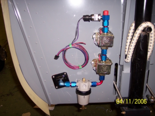

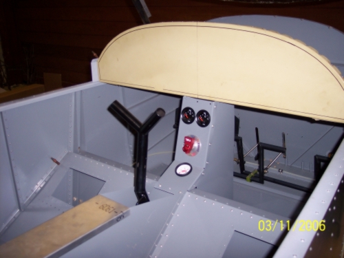

Does anyone know where to get the tach for the corvair powered 601's? I am looking for the one that uses the counts the flywheel teeth. I have just installed the fuel pumps, selector, pressure gauge and fuel quantity gauges and wanted to send the PICS. Hope they aren't too big.
