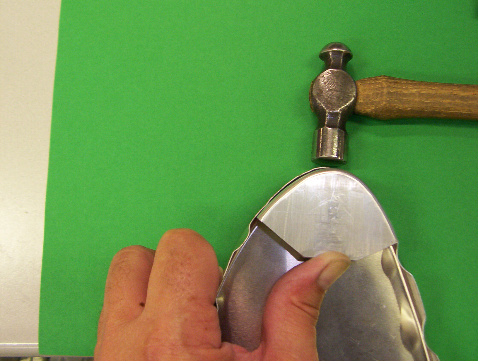

I used 3/4" MDF and polysealed em. Worked great. I did make up a small aluminum block to qualify the nose radius wrinkles. Picture attached:
I used a polished face hammer and just shrunk out the wrinkles by gently tapping the material to conform with the backing block.
Process on mykitlog here:
http://mykitlog.com/users/display_log.php?user=rlendon&project=113&category=0&log=18313&row=99
Small radius block of 3/4" aluminum to backup the short flange to qualify out the wrinkles.
