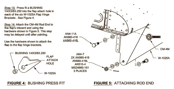

Hi All,
I’m building slow build and due to Canadian inspection rules we have to deviate from the construction sequence in the manual a fair bit. Somewhere along the way I’ve missed the instructions on installing the bushings into the 1025A flap brackets. We looked through the book for 20 min. last night and did not find it. Could someone please tell me what page it’s on.
Perry Casson
Regina, Canada
| Back to top |
n8vim(at)arrl.net Guest
Posted: Wed Nov 08, 2006 6:58 am Post subject: flap bushing install |
Page 22-8
Pic attached.
-Jim 40384

Deems Davis
Joined: 09 Jan 2006 Posts: 925
Posted: Wed Nov 08, 2006 7:01 am Post subject: flap bushing install |
Sec 22-8 step 13 figure # 4

rene(at)felker.com Guest
Posted: Wed Nov 08, 2006 7:07 am Post subject: flap bushing install |
I can not remember where the instructions were, but make sure you have your bottom skins on first before to press them in. Sorry, I do not have my plans here to find the reference.

LloydDR(at)wernerco.com Guest
Posted: Wed Nov 08, 2006 7:28 am Post subject: flap bushing install |
It is on page 22-8, Figure 4, bottom

armywrights(at)adelphia.n Guest
Posted: Wed Nov 08, 2006 3:17 pm Post subject: flap bushing install |
Having bottom skins on is not mandatory, just in case you’re trying to now push them back out. You just have to gently spread the slot around the bushing as you attach the bottom skins.

pcasson(at)sasktel.net Guest
Posted: Wed Nov 08, 2006 8:32 pm Post subject: flap bushing install |
Thanks for your help guys – My page 22-8 was rev 0 which does not have any mention of installing bushing or have a figure 4. Talked to Vans and saw the updated page James Hein sent and even found bushings. All is good.
