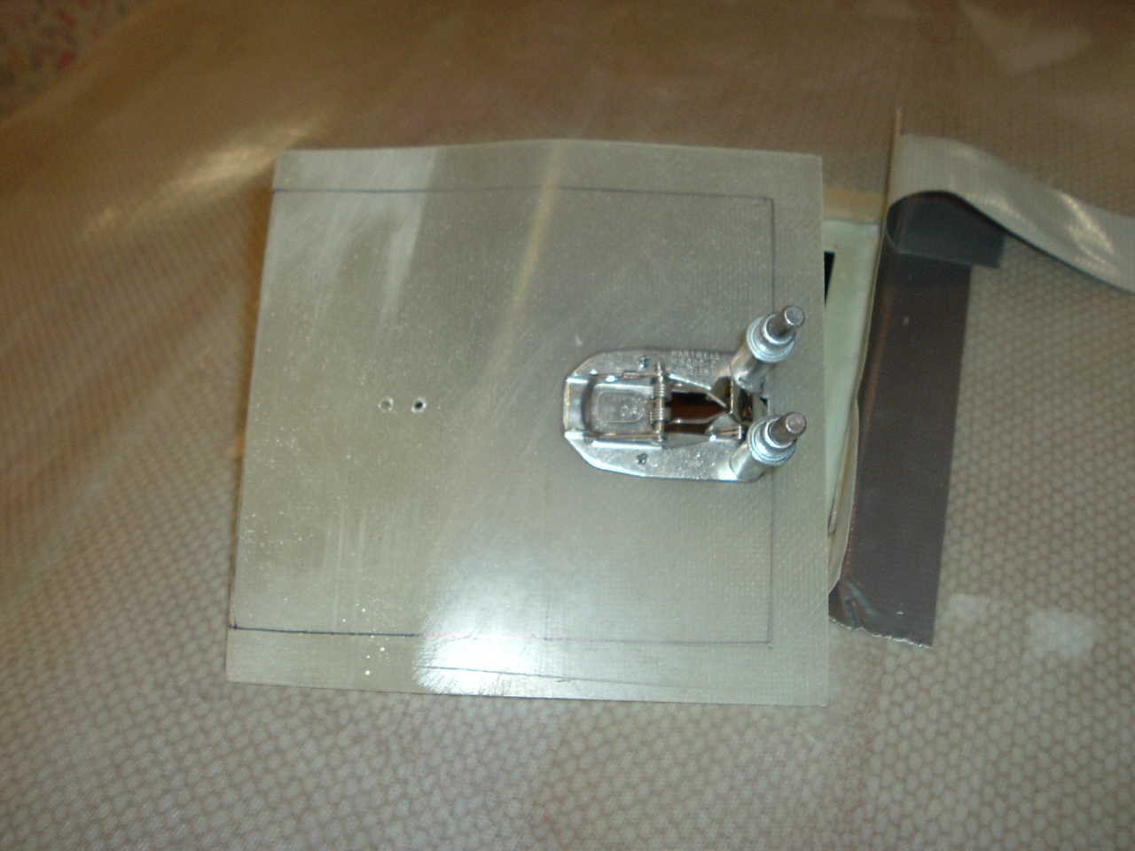

PostPosted: Fri Oct 27, 2006 10:08 pm    Post subject: oil door latch Reply with quote
Chris,
Here is what I did vs buying the parts for TOO much money. Make it yourself and save.....I did pay $14 for the latch from the ALUMINUM PEOPLE at Oshkosh.
Dean 40449
