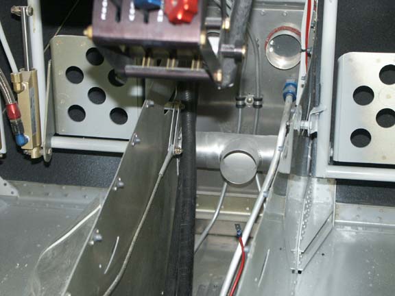

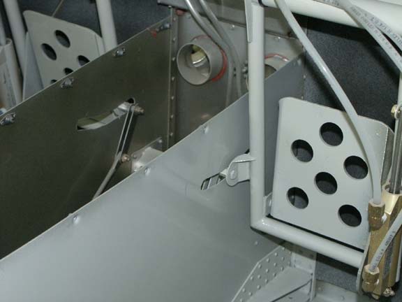

Randy (#006) got a ding on his DAR inspection for the connection of the rudder pedal cables to pedal attachment. It was in regards to bolt, nut and cotter pin orientation. The DAR was concerned that footwear would disengage the attachment over time.
One of my 200+ changes was to weld a horizontal tab off each inboard vertical pedal mount (cutting away the factory vertical attachment)and scribe an arced cut-out into the tunnel sidewalls. The objective was to keep the cables straight inside of the tunnel. Connection was from within the tunnel, eliminating the connecting hardware on the outside sidewalls of the tunnel. Every bend and every inch of tubing increases the resistance to the cable movement.

A friend and I went up to John Nys this weekend and I took these shots of a 10 he is working on in his shop. I think this is the type mod you are describing.
gary

wcurtis(at)core.com
PostPosted: Wed Nov 01, 2006 10:18 am    Post subject: Tunnel damage from rudder cable Reply with quote
This is a great idea! Now you gonna make me take my installed rudder pedals apart so I can do this mod. >A friend and I went up to John Nys this weekend and I took >these shots of a 10 he is working on in his shop. I think > this is the type mod you are describing. >gary > >Attachments: >http://forums.matronics.com//files/pict1320s_450.jpg >http://forums.matronics.com//files/pict1316s_174.jpg William Curtis http://nerv10.com/ [quote][b]

Are those AN3's? Do you know if John did his studies to ensure they can withstand the forces on the pedals?

Didn't ask. I would think that a 3 would be an absolute minimum. I am also a little concerned about the design of the tab flexing in a max petal deflection.
But that is all about experimental building. The concept is there, now the next improvement Question

I noticed that his rudder pedals had a horizontal tab at the cable attach point. My cables do not have this. Did John add these to allow for possible deflection? >Didn't ask. I would think that a 3 would be an absolute >minimum. I am also a little concerned about the design >of the tab flexing in a max petal deflection. > >But that is all about experimental building. The concept >is there, now the next improvement [Question] > >> Are those AN3's? Do you know if John did his studies to >> ensure they can withstand the forces on the pedals? >> Anh >> #141 >>>http://forums.matronics.com//files/pict1320s_450.jpg >>>http://forums.matronics.com//files/pict1316s_174.jpg William 40237 - Fuse/Finish http://wcurtis.nerv10.com/ [quote][b]
