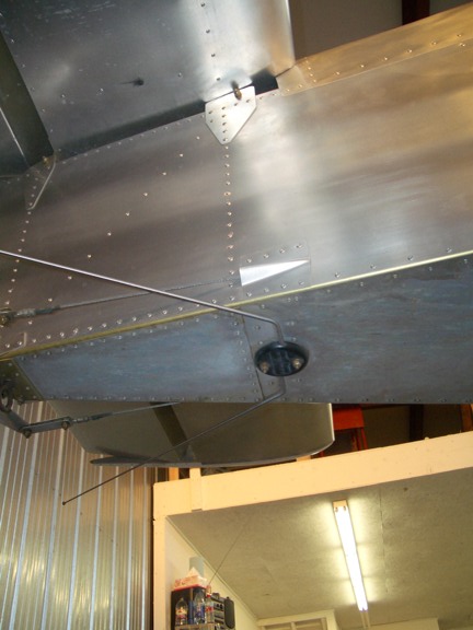

That's a lot of stuff to put on the 601 Rudder. I'd go with the tail light and maybe an antenna but the Beacon isn't required as long as you have strobes but if you must have it put it somewhere else.
All that I'll have on mine is the tail light and the wires run straight from it forward to a hole in the front of the rudder.
Look on my web site under the "Tail" button for some pictures.

PostPosted: Tue Nov 07, 2006 9:33 am    Post subject: Re: Antenna(s) Reply with quote
My plane has a Dipole VOR/GS/Localizer Antenna, probably a Comant CI-157P. This is mounted on the bottom of the fuselage just under where the rudder cables exit the fuselage. See attached photo. The signal from this antenna can be shared with multiple receivers by using an antenna coupler. The only wires going to my rudder are for the white, rear position light.
Many RV's have similarly mounted a Dipole VOR/GS/Localizer Antenna.
(I also have a comm antenna and a GPS antenna on the turtle deck, a GPS antenna on the top forward skin, the belly of N601RT has a cheap bent whip comm antenna for my hand held, a marker beacon antenna, and my transponder antenna. My ELT antenna is from a handheld radio and is mounted on the baggage shelf, just behind the passenger seat. No flames please. Check the archives for discussions about ELT antenna locations. I should have put both GPS antenna's under the canopy, but didn't.)
Roy
N601RT: CH601HDS, nose gear, Rotax 912ULS, All electric, IFR equipped, 651hrs, 750 landings

Gig Giacona
Posts: 1416
PostPosted: Tue Nov 07, 2006 12:37 pm    Post subject: Re: Antenna(s) Reply with quote
Roy, that is the spot all of the old-timers who come and inspect my plane have suggested I install mine as well. Between the lot of them they probably have over 300 years of tinkering with airplanes experience.
