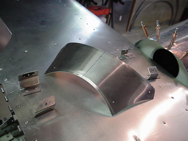

I am working on the aft top skin and have made the cut out to accept the stab. I am having trouble installing the stab with the skin in place. At first I thought I might just be too tight on the skin and need to open up my cutout in the top skin. To get the forward attachments of the stab past the mounting plates on the fuselage I need more clearance and need to be higher before they drop down into place. The only way I see to remove the stab after I install the top skin is to either open up the cut out (about 12mm) which leaves quite a gap or to drill out the attach plate to the fuselage. If you like you can see this on my site.
[url=http://www.zodiacxl.com/Top Skin.htm]http://www.zodiacxl.com/Top%20Skin.htm[/url]
Has anyone else ran into this problem?
Cheers
Matt

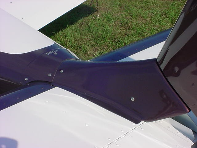

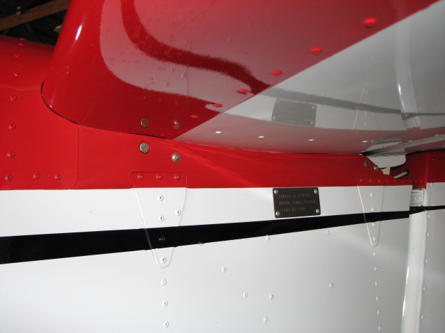

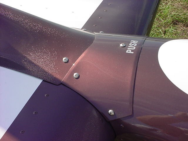

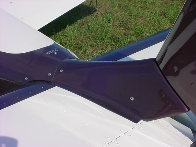

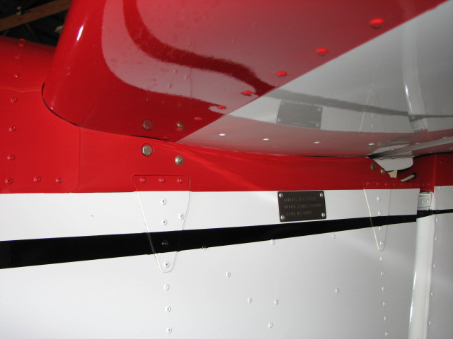

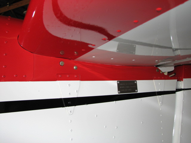

Hi Matt,

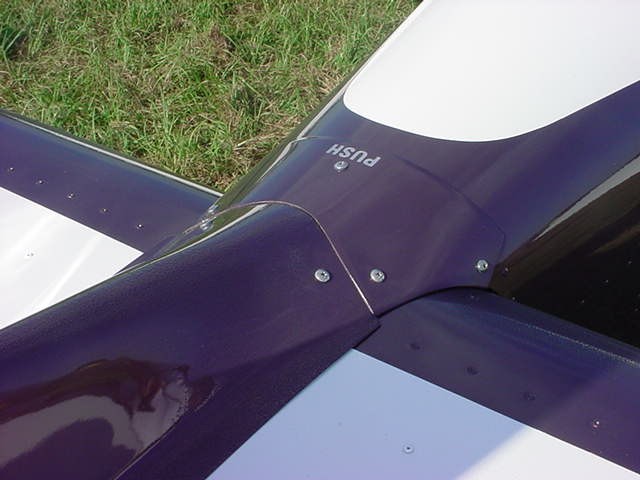

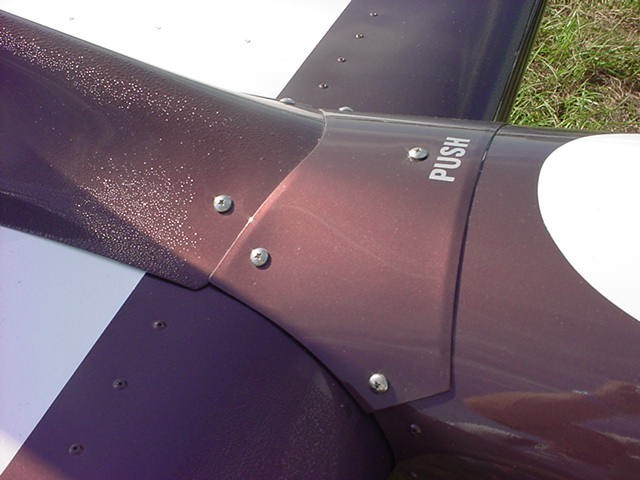

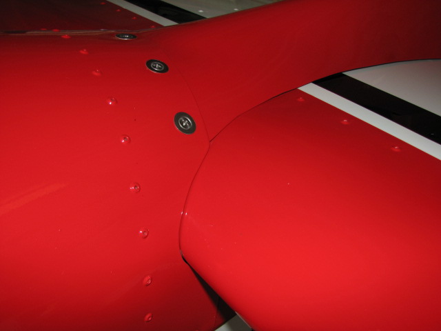

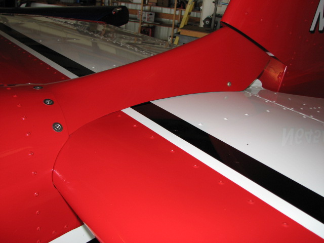

I had posted these pics a couple of weeks back because some guys were having the same problem. I have a tight fit on mine and have no problem installing the Stab. on my HDS. See pics .
Al from Oshkosh

PostPosted: Sun Oct 29, 2006 7:46 am    Post subject: Top skin cut out for stab Reply with quote
I think a lot of us have wrestled with the problem you're facing. I have opted to leave the front brackets UN-RIVETED until I do the final installation. I remove the front brackets to install the horizontal stabilizer...and cleco them on for now. It's the only way I could come up with to keep the gap small. When I'm ready to do the final install, I'll rivet everything in place.
I think it would be a great idea to redesign the fiberglass rudder fairing ....and extend it all the way up to the rear bulkhead. The top rear skin could extend about an inch or less past the bulkhead, and the fairing could slide underneath it. Scratch builders might take note of this.

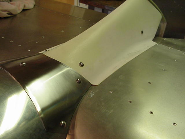

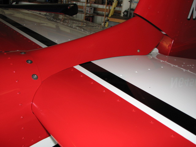

craig(at)craigandjean.com
PostPosted: Sun Oct 29, 2006 10:20 am    Post subject: Top skin cut out for stab Reply with quote

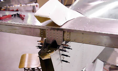

Some have the problem and some don't. I do and I asked Zenith (among others) about it. Here is what Nick at Zenith said:
"You are right, on the Zodiac, the stabilizer cannot be removed without removing one of the HT attachment brackets 6B1-9 or 6B1-8. That attached photos is what one builder did to modify the aft cutout in the rear top skin 6B21-5."
Craig again - I've attached the photos Nick sent (1.jpg, 2.jpg, 3.jpg) and some others.
I'm not sure why some have the problem while others don't. But I think the responses that simply say "there is no problem because I don't have one and here are the photos to prove it" are amusing but pointless.
-- Craig

PostPosted: Sun Oct 29, 2006 11:01 am    Post subject: Top skin cut out for stab Reply with quote
The problem is not the rudder. The problem is that the cut-outs in the top rear skin are elliptical segments, not circular. To remove the stab after the skins are riveted in place you have to rotate the rear edge of the stab up to allow the mounting brackets on the stab to clear the brackets on the fuse. The next time you have your rear skin clecoed in place try removing the stab. You may observe the problem. Many say there is no problem but others (including Nick at the factory) agree there is a problem. I've attached a photo from the photo assembly CD that seems to indicate that the rear mounting plates should not be riveted in place until the final mounting of the stab (\extras\Images\construction photos\mvc-865f.jpg).
