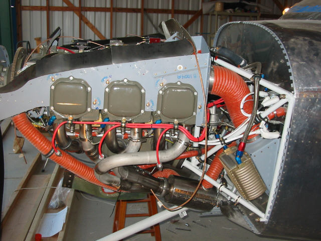

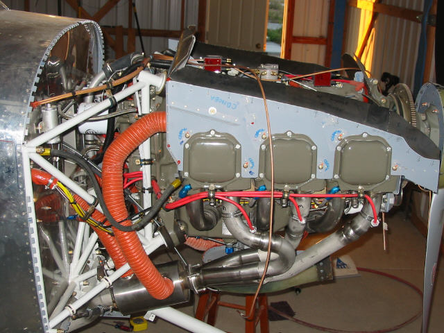

I ran my sensor wires on the right (passenger) side of my firewall, all of the power wires went through on the left. This worked out great. I used Van's wiring kit (plus many additions) and this setup worked well with the kit plans.
I used EMP Corp 1" firewall penetration seals. http://www.emp-corp.com/
Pictures attached. You can see the wires entering into the orange firesleeve.
