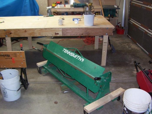

PostPosted: Thu Oct 26, 2006 6:27 pm    Post subject: Re: sheet metal brake Reply with quote
Dave,
You might want to ask around the local EAA chapter, I did and look what was loaned to me:
http://www.mykitlog.com/users/display_log.php?user=rlendon&project=113&category=0&log=11732&row=165
Here is a picture of the 48" TennSmith attached:
I did wrap a couple pieces of .040 around the nose to get the radius I needed. The are just two way taped in place.
