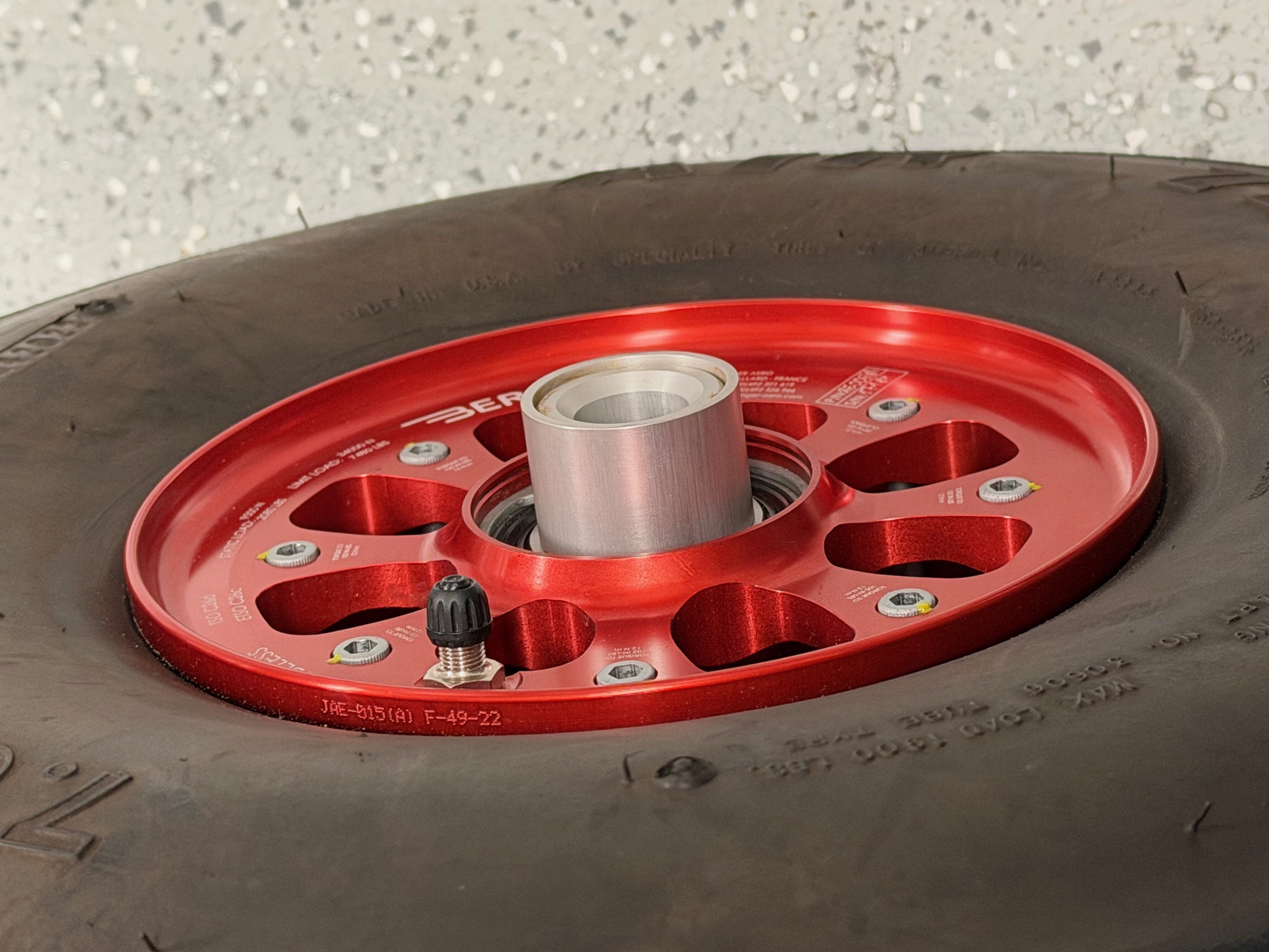

Hi Guys,
I am in the process of installing a Beringer wheel on my mono and noted that the spacer that is installed on the port side of the wheel Is proud of the axel. See picture. Is this normal?
I ask because I have to push apart the swingarm to get the wheel in place. Without the spacer on it slides right into place. I am thinking I need to trim the spacer to length such that it’s is flush with the end of the axle. BTW, I verified that the axel is fully seated against the inside face of the S.B bearing.
I thought I would reach out to this group before contacting Beringer as I know a few folks have installed this wheel.
Thanks.
Erich Trombley

PostPosted: Tue Nov 25, 2025 12:18 pm    Post subject: Re: Beringer Wheel for Monowheel Reply with quote
Erich,
In the original setup the axle LG18 establishes the width of the swing arm arms. So I'd guess match that length.
How many knots will this gain you? Smile
Jim
