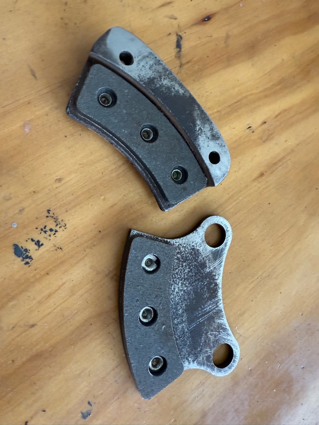

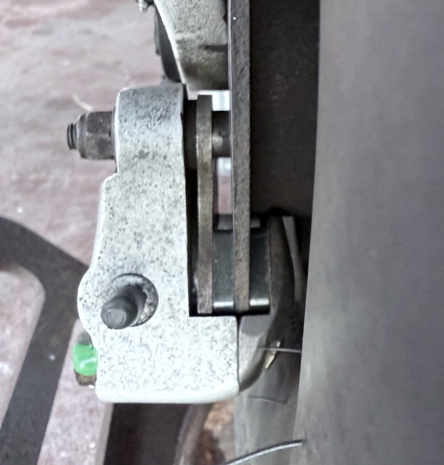

PostPosted: Sat Jul 19, 2025 3:17 am    Post subject: Re: Brake Caliper Blocks Reply with quote
Job done 👍

PostPosted: Sun Jul 20, 2025 7:34 am    Post subject: Re: Brake Caliper Blocks Reply with quote
Rapco pads work well and we are now using Matco pads. They are a little less aggressive material.
You photos look like the head of the rivet is on the plate. Most instructions call for the head to be on the pad so there is more area touching the pad itself. Small point for future reference. We've done them both ways!

PostPosted: Sun Jul 20, 2025 8:11 am    Post subject: Brake Caliper Blocks Reply with quote
Just a slight worry: when the head of the rivet is on the pad, as designed, there will be a more evenly distributed load on the pad. This might be an issue because the pad material is brittle and it may be subject to higher stress if the rivet head is on the plate.
Hopefully there will be a high enough safety factor for it not to matter?
It may be worth keeping a close eye on how the pads are wearing because the pad life will be shorter and the rivetted end will gouge the disk sooner and more than the flat head would.

PostPosted: Mon Jul 21, 2025 2:20 am    Post subject: Re: Brake Caliper Blocks Reply with quote
Thanks for the info guys; yes fitted Cleveland Parker friction blocks... I put the new rivets as the old ones were fitted, and points noted. The catalogue shows rivet orientation as you mention. Might get another set of rivets and redo them. It's not a big job to R&R.

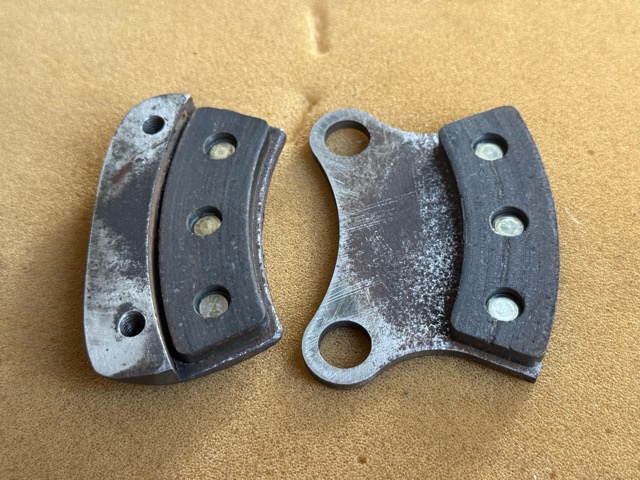

PostPosted: Wed Jul 30, 2025 3:02 am    Post subject: Re: Brake Caliper Blocks Reply with quote
Now they are correct; the Cleveland Parker catalogue is difficult to see orientation but does show it correctly. The rivets for the removable section need to be slightly longer reach.
