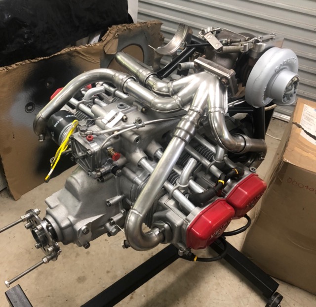

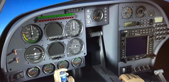

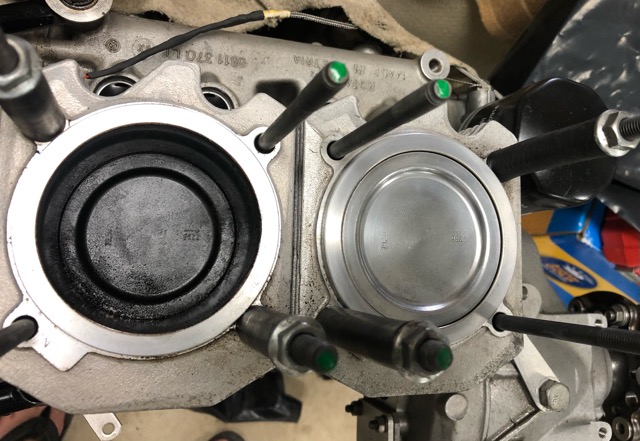

Finalised the IFR panel design format for 181 by removing the Garmin GMA340 and King KLN94 and replacing them with Avidyne IFD540, annunciation panel, and PS8000 audio panel... Getting ready to fit fresh carbi kits on the 914 engine rebuild which has bolted up together very nicely. Waiting to see what santa brings!

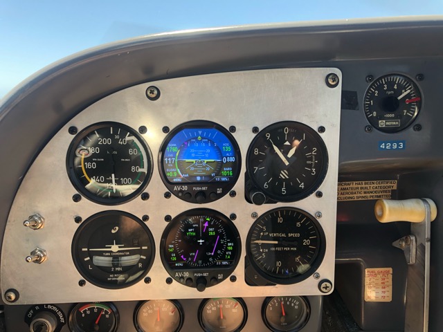

Went for a fly for an hour up the coast today to look at a TBO'd 912is Sport... 181 was seeing a steady 120kt indicated at 5100 on 11Lph with its originally fitted 80hp... Not sure yet if the isSport is worth pursuing; would need a bulk strip and overhaul to meet the personal minimums...
