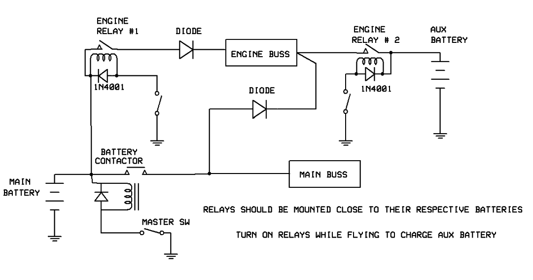

Below is a circuit with an aux battery for the engine bus. Suggestions welcome.
 Filesize:  21.65 KB
 Viewed:  27360 Time(s)
Joe Gores

Currently my engine bus is always live (connected to battery via
fuseable link).
I'm thinking of inserting a DPDT switch between the main battery and
engine bus. In normal operation engine bus would be connected to main
battery and the second pole to a diode from alternator/main battery to
charge the backup battery. When throwing the switch that diode would be
disconnected and the engine bus connected to only the backup battery. Of
course that makes that switch a single point of failure.
The way I see it I want to protect against:
1) Overvoltage from  alternator reaching battery, main and engine bus.
2) Alternator short to ground shorting battery, main  and engine bus.
3) Dead main battery and/or alternator not affecting back-up battery and
engine bus.
Obviously also need to be able to shred non-essential loads to extend
flight time. There a backup battery would extend running time in case of
failed alternator and good main battery.
