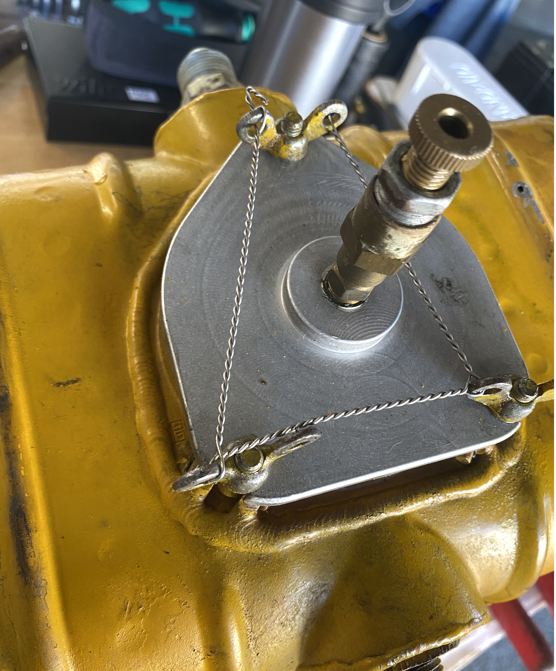

CJ6A Fuel Collector drain fitting. If I remove the cylindrical fitting (with attached Hex nut) what sort of gasket lurks on the other side ? If anyone has an image of the inside or a part number etc I would appreciate it. There is Nothing in the parts or other CJ manuals on this.
End game is to fit a curtiss style Drain valve here.

This what I have Sean. We did have a small leak under the strap holding the header tank that was welded. It has been cleaned up and repainted with new fitting. I can send a better pic when I RTB next week.

Finally got round to getting this done. SAF-AIR CAV-180 drain installed.
