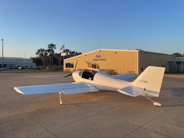

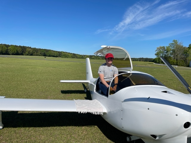

Some fun pics of N11EU doing it's job of providing enjoyment!

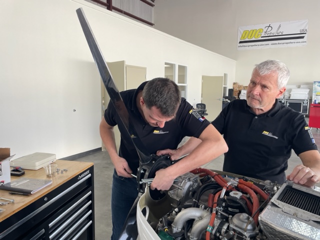

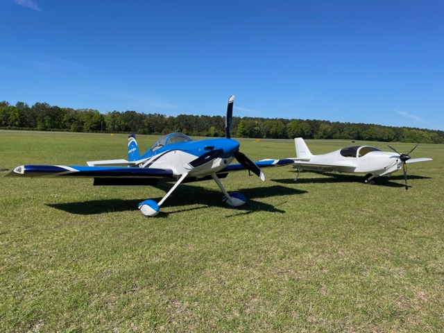

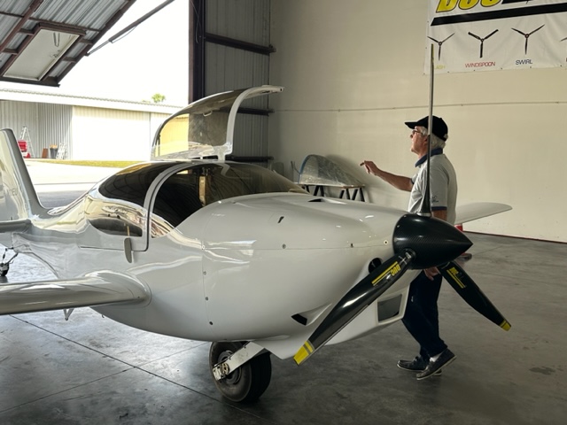

During the DUC open house in Sebring. Got a new $$CF spinner (the one I had before was terrible).
One pic shows Monsieur DUC himself inspecting the prop install by his son. It was fun to sit back and watch someone else work on my plane for a change Smile

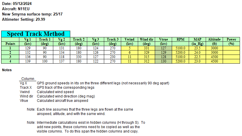

OK, so in the interest of accurateness, I went up this morning when it was relatively calm and did 3 and 4 leg runs and used the very handy National Test Pilot School (NTPS) GPS Pitot-Static-Error spreadsheet to calculate Vtrue and the results are not quite as optimistic as my previous quick estimate but not too bad anyway. I include the output from the spreadsheet so you can look at it there.
As a summary, I normally plan for 130 knots true at 5100 RPM at 4500-5500 feet as I mentioned. The check this morning shows that at 5100 I get 127 knots at 3000' and 128 knots at 4500' (MP 23.5 and 22.5 respectively). At 5200 RPM the speeds do go up to 129 knots at 3000' and 130 knots at 4500' (MP 24 and 23 respectively).
I looked at measurements I took in 2021 with the same prop with a little more pitch and the speed kit (which I still have to paint and re-install) and I was getting 135 knots true at 4200' and 5100-5200 rpm. I reduced the pitch slightly which did make me loose some of this speed, but I like the takeoff performance better now, although it wasn't that bad before. I could get about the same climb with both finer and coarser pitch but the transition from 60 knots to 110 knots used to be a little sluggish and the RPM would drop to max torque at 4900 RPM. Now it stays at 5100+ RPM, the ground run is much shorter and no longer do I experience sluggishness when I retract the flaps and accelerate to cruise climb speed. It just feels better.
Overall, I am very pleased with this engine/prop combination and the current setup.
Chris
