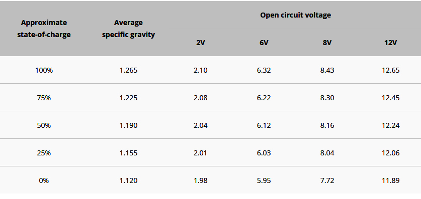

Note in attached figure (shamelessly stollen
off BatteryUniversity.com), 0% state of charge
on a 12 volt produces an open circuit reading
on the order of 11.9 volts.
You cited an open circuit voltage of 2.2 volts . . .
Hmmmm . . . less than 0% state of charge?
Actually, yes. Active material in the plates
had sucked still more acid from the electrolyte
than what would produce any useful energy
from the chemistry.
The closer to pure water . . . the more depressed
conductivity. Hence, first attempts to push energy
back into the battery will be met with lots of
resistance . . . no pun intended.
