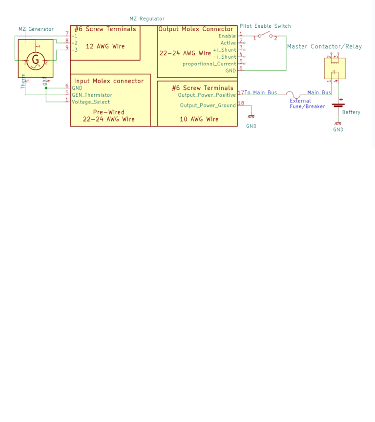

The Monkworkz MZ30L is NOT wired like most alternators. Read the installation manual.
https://docs.google.com/document/d/1BckaSN06Lv4BYY07AfHk3YRvx8b60yybpX0qHB-Mymc/edit
Below is my interpretation of the owner's manual.
ALL of the wires from the MZ30L go to its regulator and no place else.
Not counting the wires between the generator and regulator, a minimum of 4
wires are required to be connected to the regulator. Regulator pins 1 & 6 go to
an enable switch. Regulator pins 17 & 18 go to the main power bus and ground
respectively. 10AWG wire could be used for pins 17 & 18. The fuselink would
then be 14AWG.
The other pins on the regulator are optional and are for an external indicator
light and signal outputs to a customer supplied ammeter.
The Monkworkz MZ30L is self current limiting. If overloaded, the output voltage
will automatically decrease to limit the current.

Overview architecture updated to include MonkWorkz-specified installation.
Engine bus (approved by SDS) also attached.

20240128 Z12 140455 V2.pdf
MonkWorkz updated
Download
 Filename:  20240128 Z12 140455 V2.pdf
 Filesize:  232.58 KB
 Downloaded:  609 Time(s)

PostPosted: Mon Jan 29, 2024 5:31 am    Post subject: Re: Z-12N based architecture review request Reply with quote
Esco, your schematic shows 4 wires going from the MZ-30L generator to the aircraft electrical system.
The MZ-30L installation manual shows ZERO wires going from the MZ-30L generator to the aircraft electrical system.
All of the wires from the MZ-30L generator must ONLY go to the regulator. None go to the aircraft.
Only the regulator has wires going to the aircraft electrical system. The generator puts out 3 phase AC.
Therefore it can NOT be connected directly to the aircraft DC electrical system.
The generator can only be connected to the rectifier / regulator.

PostPosted: Mon Jan 29, 2024 7:52 am    Post subject: Re: Z-12N based architecture review request Reply with quote
Joe: thank you very much!
You're absolutely correct.
I read the installation manual, specifically "2.2. Minimum Installation / Required Connections" several times... and still misunderstood. I'll make the updates tonight!

PostPosted: Mon Jan 29, 2024 4:49 pm    Post subject: Re: Z-12N based architecture review request Reply with quote
Revised to show MZ30L: all aircraft connections at regulator only.
20240129 Z12 140455 V3.pdf
Added MonkWorkz installation schematic
Download
 Filename:  20240129 Z12 140455 V3.pdf
 Filesize:  297.96 KB
 Downloaded:  582 Time(s)

PostPosted: Tue Jan 30, 2024 3:11 pm    Post subject: Re: Z-12N based architecture review request Reply with quote
The MZ-30L regulator output terminal 2 provides ground for an indicator light.
The light needs to get positive from a fuse connected to the aircraft main power bus.
Notice that there is a "Pilot Enable Switch".
Every aircraft should have one of those, even aircraft without an electrical system.

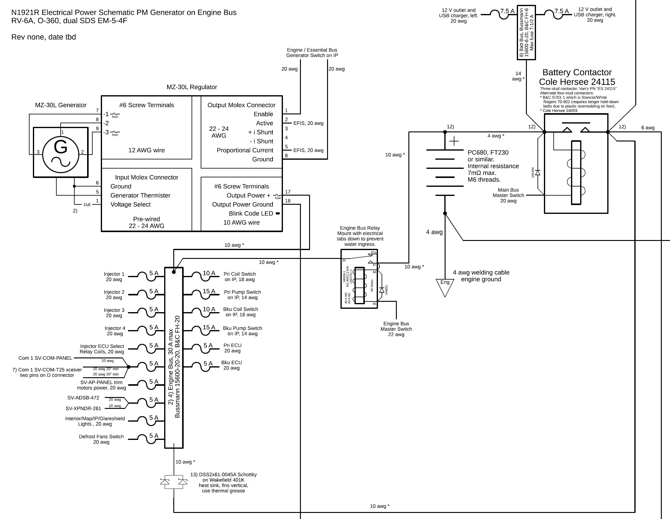

PostPosted: Wed Jan 31, 2024 10:57 am    Post subject: Re: Z-12N based architecture review request Reply with quote
esco wrote:
... Bill Judge is very clear about the need to connect to the switched side of battery contactor...
It is not necessary to connect the Monkworkz regulator current output to the switched side of the master contactor/main bus, only that it be disconnected from the battery somehow while parked to prevent its parasitic load from depleting the battery.
I show it connected to the engine/essential bus which is on the forward side of the firewall. This way the engine will run with the main bus offline, for instance in the smoke in the cockpit scenario. Snip attached. More complete PDF schematic in folder 1) / A) here
The OP has seen this but maybe others have thoughts.

John Bright, RV-6A N1921R, working on FWF.
Single battery, alternator on main bus, Monkworkz generator on engine/essential bus.
