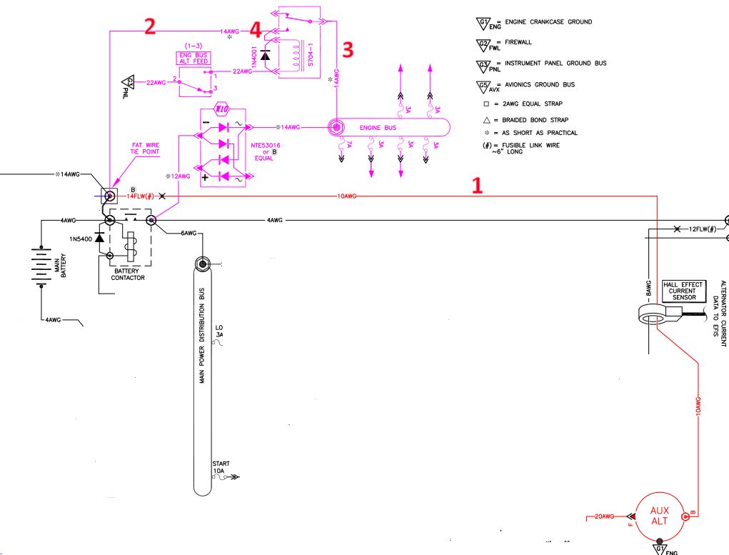

I have an additional question here concerning Z101 which I use in my RV-10.
On the RV-10 the battery is behind the baggage compartment so that brings some question concerning wiring here the part of Z101 which shows that:
[img]cid:part1.GWAeFQX8.SUBWtEuy(at)gmx.net[/img]
The wire marked with 1 (feed line aux alternator) would be about 14 feet long, I plan to protect that wire with an ANL 40A fuse on the FW close to the alternator, but it would be always (unfused) hot on the other side as the battery is directly hooked to that wire.
The wire marked with 2 could be very short if the relay 704-1 is placed close to the battery
The wire marked with 3 would be again about 12 feet long, but would only be hot when either relay is on.
In this situation I would have 3 wire runs along these 12 feet #1, #3 and the starter wiring (I use 2 AWG there because of length) and #1 and the short #2 would always be hot.
Now I could reduce the wire runs, if I would move the Alt Bus feed relay (704-1) to the front and hook #1 wire directly on point #4 to the relay, I would still have the long #2 and the short #1 wire hot. But in summary its still one hot wire run along the fuselage.
I could mitigate that by moving the ANL fuse to the rear, but introducing a risk, if the Aux alternator is on, that the protection of the wire is on the other end of the source (Aux alternator).
Many thanks for the consideration and tips on that question what is best or common practice.
Cheers from Switzerland
Werner

PostPosted: Tue Jan 23, 2024 6:43 pm    Post subject: Re: Z101B and battery in the rear wiring question Reply with quote
In case of an immanent forced landing or smoke in the cockpit, the pilot should
have the ability to shut off all electrical power as close to the source as possible.
To comply with that rule, the battery contactor and other relays should be located
near the battery. The starter contactor may be located at the firewall.
Z-101 was not intended for a rear mounted battery. And so I recommend connecting
the 10AWG aux alternator wire that you have labeled "1" to the starter contactor
just like the main alternator is with a fuselink. If you do that, then
there will not be always-hot wires running from the back to the front.
Alternators do NOT need to be protected against producing too much current.
Alternators can not produce much more than they are rated for. Protection for
alternator feeders should be located closer to the battery end, not at the alternator end.

PostPosted: Wed Jan 24, 2024 12:27 am    Post subject: Z101B and battery in the rear wiring question Reply with quote
Thanks a lot Joe for your thoughts,
if I connect the wire 1 at the starter contactor I would defy the idea
of Z101, that the aux alternator can feed the essential bus without
switching on the main contactor, so I rather would like to keep that as
in the original architecture.
The main alternator feed can be protected close to the starter contactor
here, as it would need a huge fuse when being close to the main
contactor (starter current).
Unfortunately due to CG reasons I need to have the battery at the rear
end I agree would be easier/more logical on the FW.....
Cheers Werner

PostPosted: Wed Jan 24, 2024 2:23 am    Post subject: Re: Z101B and battery in the rear wiring question Reply with quote
That is not correct. If your wire #1 is connected to the starter contactor, then
the path is from Aux Alt to starter contactor to downstream side of battery
contactor to pink bridge rectifier diode to normal feed to brownout/AUX Bus.
You might have to reduce the main bus electrical load depending
on the capability of the aux alternator.

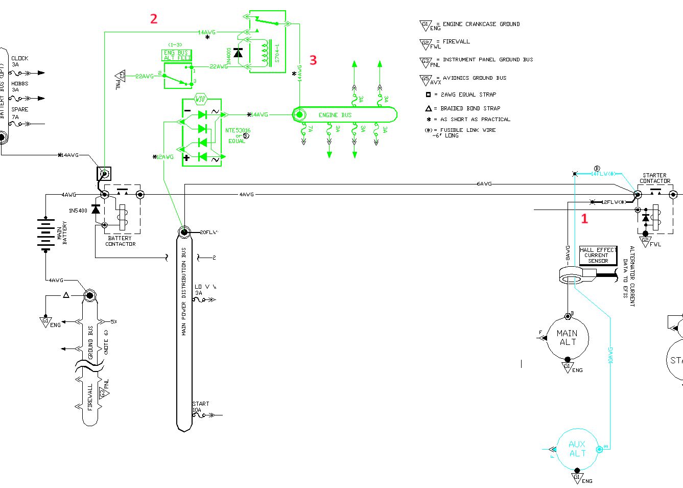

PostPosted: Wed Jan 24, 2024 3:09 am    Post subject: Z101B and battery in the rear wiring question Reply with quote
Hi Joe,
how could I doubt your advice Sad (I just overlooked that path via the diode)
That is very elegant, as the Aux would source the whole system the wire
run would be short (and common to both alternators) (you would not use
the blade fuses instead a fusible link in front of the starter contactor
point?)
So there would be a bit a different logic:
- standard feed by main alternator to both buses
- in case main fails Aux takes over all buses (independent if battery
contactor is on or off (but should remain onĀ  to have stabilizing
battery in system), reducing load on main bus could keep load in limits
of Aux alternator
- in case both fail the alt feed switch would connect the
essential/engine bus directly to the bat.
Simple and elegant, I bow my head to you for that solution, thank you!!
Werner

PostPosted: Wed Jan 24, 2024 4:06 am    Post subject: Z101B and battery in the rear wiring question Reply with quote
So it would look something like this, only long wire would be #3 but could be disconnected via the relay high concentration on starter contactor now of # of connection
[img]cid:part1.3lu8MK3M.Dp1gWLLD(at)gmx.net[/img]

PostPosted: Wed Jan 24, 2024 7:49 am    Post subject: Re: Z101B and battery in the rear wiring question Reply with quote
Werner, some well respected people like Bob N. and Charlie E. prefer to use
fusible links instead of ANL fuses. Fusible links have advantages: light weight and
no exposed terminals that could short out and less money. It is a matter of personal choice.
