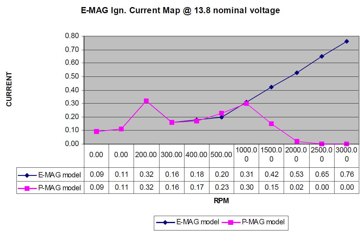

I'm writing because I believe it is incorrect that the Pmag bus power feeder is "about 0.04A". I have no idea where you got that number. This feeder is EI power for starting and in case of Pmag internal
You are correct. Emag specs and installation sheets are not
satisfyingly clear on their electrical requirements.
Had to dig around in some older EMag literature
to come up with the attached illustration:
That 0.04A number was for bus supply loads
under normal operation above 1800 rpm or
so on a PMag. Obviously, should the internal alternator
fail (exceedingly unlikely) demands from
ship's bus will be on the order of 0.3 to 0.7A
depending on rpm.
NOTE: the attached figure is exemplar data
captured from EMagair literature from
some years back.
