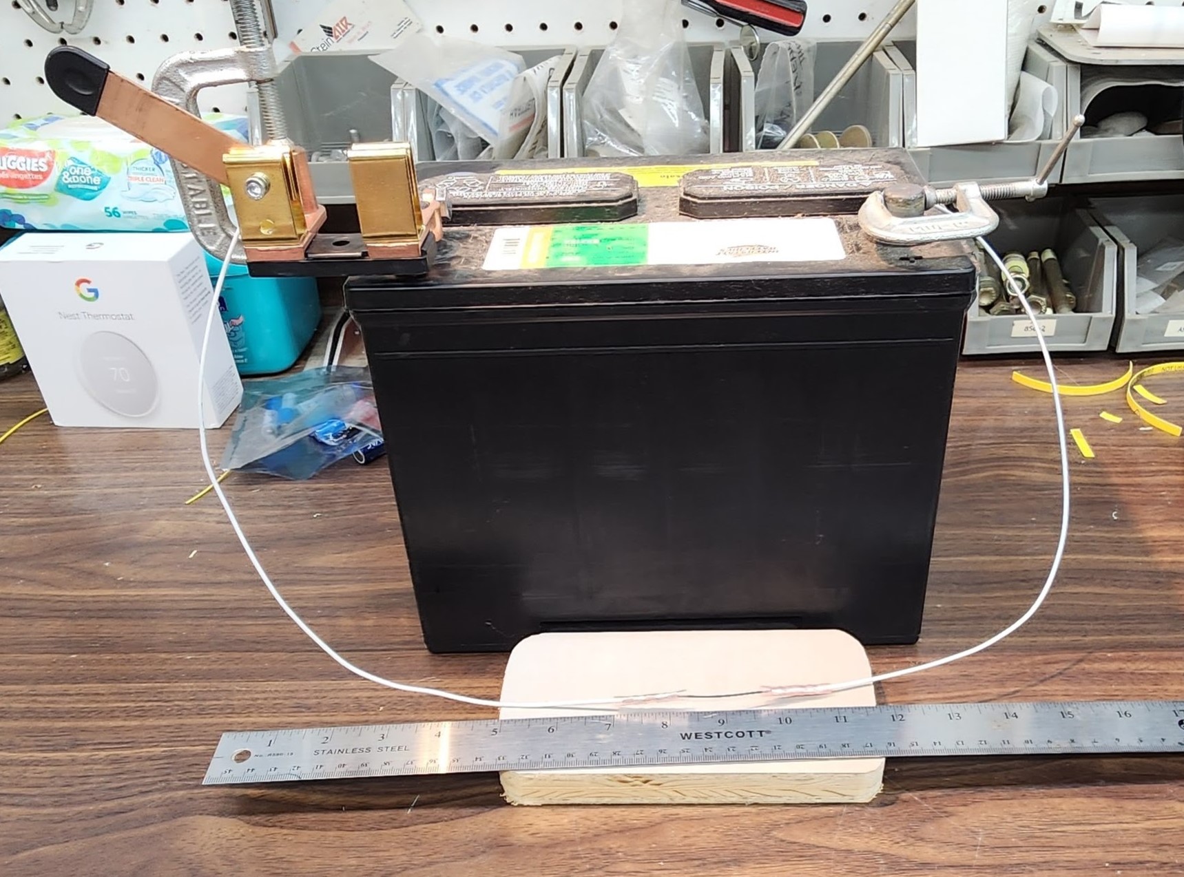

My very basic test rig with somewhat empirical results- no measured data.
Objective: observe failure of fusible links of various lengths when subjected to a high current short circuit event.
12V wet cell, new, fully charged battery
Knife switch
18 ga tefzel feeder, 20" length x2
PIDG style butt splices (red)
Camera
DUT: 2", 6", 13" lengths 24 ga tefzel FLĀ (M22759/16)
Procedure:
Fabricate fusibleĀ links of 2, 6 an 13 inch lengths

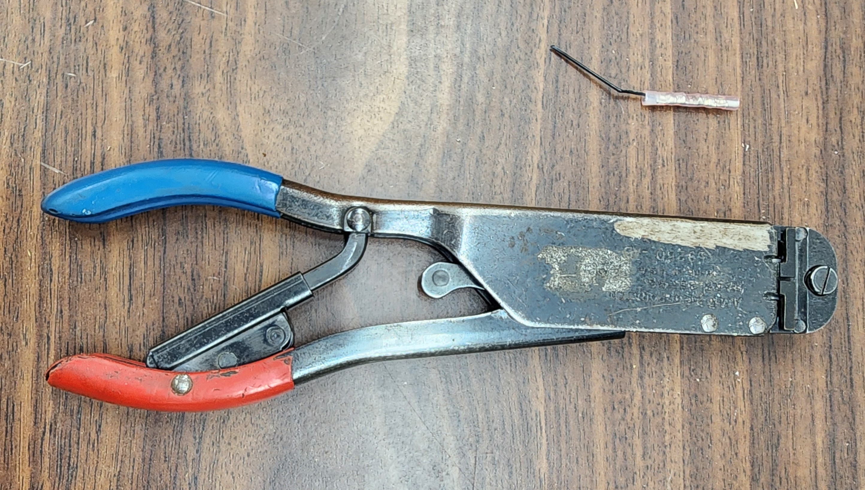

Crimp w/ AMP PIDG crimper to
Feeder 20" 18 ga tefzel
Clamp feeders to B+ Knife switch and B- battery terminal
Start camera video
Rabidly close switch
Two inch FL setup
[img]cid:ii_lqo7bxra0[/img]Crimp tool and butt splice

results:
http://tinyurl.com/mryadbfx
No fiberglas sleeve was used so that failure could be observed.
Comments, questions, critique!
