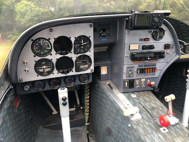

Wow what an epic journey this one has been. After months of developing solutions and some failures along the way 181 has finally received its planned upgrades, entering a new level of fit for purpose.

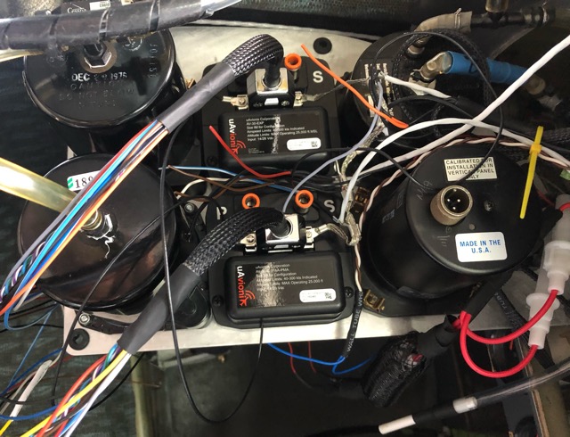

Second AV-30 now fitted offering separate AH and DG appointment, completing the full traditional Six Pack. Also fitted Uavionix TailbeaconX ADSB Mode S ES transponder, Uavionix AVMAG magnetometer paralleled to both AV30's, Davtron OAT thermocouple sensor coupled to DG unit providing TAS DALT, NMEA GPS Flight Plan data integration paralleled to both AV30's from Garmin Pilot III. AV30E latest firmware loaded to DG unit offering full flight plan graphical waypoint display. 30W 6chip LED landing/flight lights fitted at each outrigger station, new improved 3D printed outrigger speed kit cowlings fitted. Panel wiring cleaned up. New laser cut instrument panels fitted. New 3D printed GPS Pilot III mounting fitted. New trial 3D printed panel tags added.
It was epic. Lot's of stuff failed; even after successful bench testing. But quality assurance checks at various points identified faults and prevented catastrophe down the line.
The Garmin GTX327 originally selected worked great. The 2nd hand altitude encoder did not. After wasting hours setting up bench testing rigs it was decided more time efficient to just go out and order a new transponder. TailbeaconX proved a challenge on mounting it somewhere that did not look out of place. The middle flap horn cowling was selected. After ten failed 3D printed TBX mountings the eleventh passed all the requirements. The outrigger cowling took nine attempts to get right after finding left and right side factory cowlings are not symmetrical. That was solved with new fixing holes being drilled and the overal cowling width increased by 5.0mm for hassle free fitting and removal. Wiring was routed from the wing root cavity out along the flap cavity to both outriggers and secured with polyurethane. The 3D printed BeaconX housing was flow tested and returned 72g of excess drag at 100kt.
Initial post bench test quality control of the panel wiring after fitting to the AC failed. Upon pulling the gyro fuses to save battery power faint sizzling was heard behind the main instrument panel. No guesses what the cause was going to be. One of the crap D-Sub connectors was experiencing high resistance voltage tracking (a high risk of panel fire existed at this point); they are a real shit connector solution and not even true milspec; a really disgraceful blight on modern aviation and I have no idea why they are still employed... So after ripping out both D-subs a whole day was spent making up two new connectors with much higher quality components and patching them in. (Fire risk failed connector cut open inspected confirmed and thrown into the bin where it and all others like it belong)... With everything now functioning as required a final load test was performed on the electrical system; 6.8A all aircraft electrical items functioning simultaneously.
Why use the Garmin Pilot III, its so out dated? GPS NMEA data protocol has not changed over the years, only the screen graphical display has. The Pilot III provides a horizontal vertical track guidance bar which can be used similar to ILS; a nice option to have allowing arrival at waypoint altitudes at desired rates of climb or descent and only seen now on very expensive units. Eventually this will assist in driving and monitoring an AP solution.
After nearly three weeks of solid unrelenting work and 12 hour days the lights finally went on at 10.30 last night; ready for op's. Waiting for ICAO Mode S HEX code to be allocated before flight testing. Post testing items required before op's; supplement current AV30 and Flight Light inline fuses with dedicated panel mounted fuse holders.
That's all for now, wishing all a good and prosperous year!
Looks great; can't wait for the storms to pass and go fly the 181 sky machine

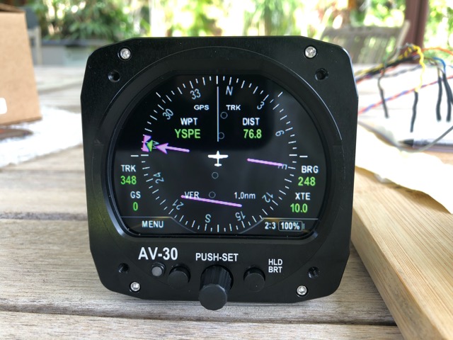

Bench testing the Garmin Pilot III NMEA data interface with the AV-30
 Filesize:  100.82 KB
 Viewed:  21520 Time(s)

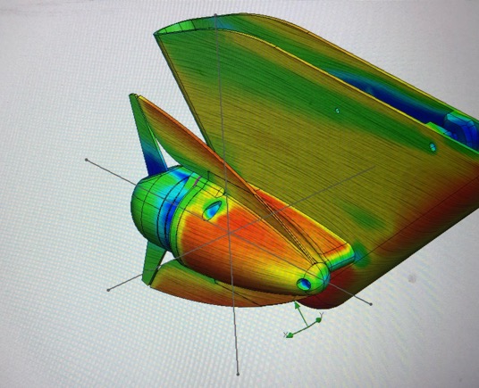

Aero testing the BeaconX mounting in the digital wind tunnel. Its too expensive an item to loose in flight to just slap on and hope for the best.
 Filesize:  82.6 KB

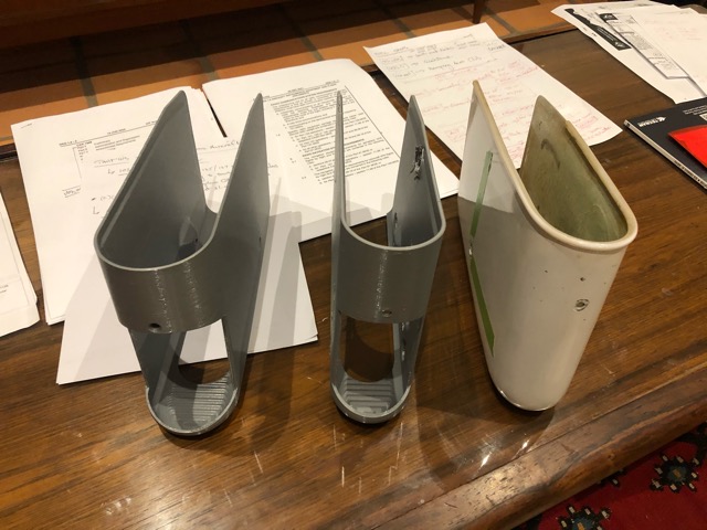

They are now fully symmetrical precision cowlings and only 80g heavier than factory

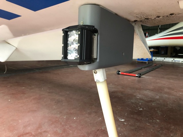

It was not that simple to fit; but it all came together with persistence and determination
 Filesize:  72.27 KB

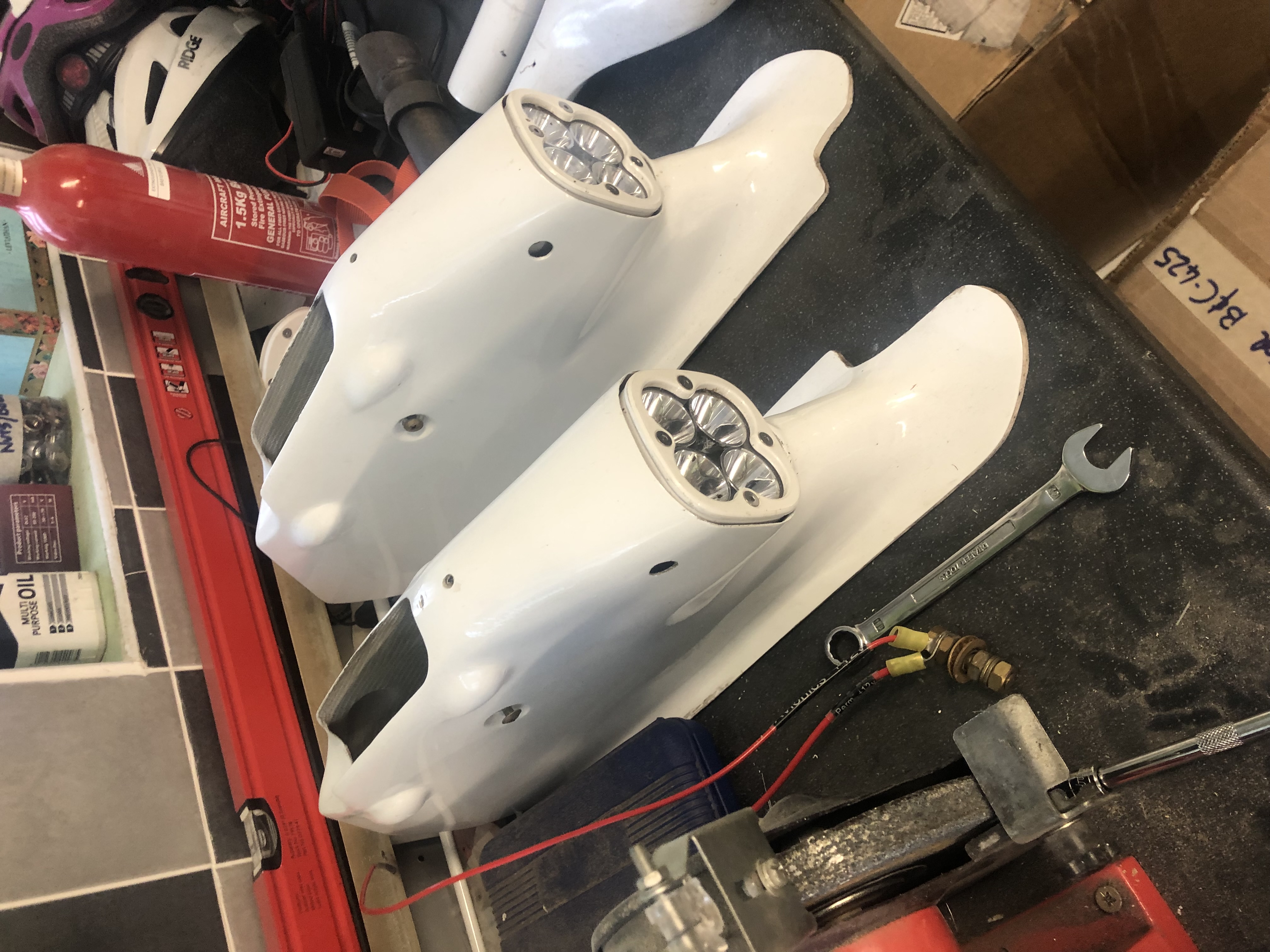

Very bright, 6 5W 6500k cree chips per lamp. 2.4A per side.
 Filesize:  138.42 KB
 Viewed:  21519 Time(s)

I didn't like the TBX anywhere on the europa's rudder. I tried it on the horizontal stab also and didn't like it there either due to the need to cable all the down to that position. Thought about laying it with the dipole on the horizontal but was informed by supplier it needs to be vertical orientated with gps chip facing upwards due to moisture drain hole position. Supplier also suggested it go inside the fuselage, but again I wanted to utilise the position light feature.

That is nice setup! Are you willing to share those 3d files?
I have been on the fence with and av-30 setup, but it seems you have to be in the ecosystem for a working ads-b solution. Your setup is impressive.
My main holdup on an AV-30 solution is working with what I already have. I wrote my own altitude encoder software that listens to pressure altitude given over wifi in NMEA format. It then relays that in ICARUS format over RS232. I have been wondering if I can utilize the signal coming from the AV-30 (using their AV-Link) and convert it. Or connect to it over rs232 to capture the data. That way I can use the AV-30 to update the pressure altitude on the GTX-327, via my script, and use the EchoUAT for ADS-B out/in. This is all hypothetical since I dont have an AV-30 to test with.
My script is on github:
https://github.com/icarus747/PicoICARUS
/Kyle

Won't be moving forward with CAD files until field testing process is complete; unknown yet whether the 3D prints will disintegrate in flight or what final amendments may be required.
