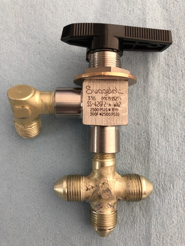

Has anyone replaced the main air system shut-off valve with a Swaglok valve? Seems I remember someone posting a Swaglok part number for the stock valve.

[img]cid:8FADFA5D-1F6C-45C7-BA8C-9B7F54B2225B[/img]

Yes, this is for the CJ. Unsure if the Yak-52 nipples are the same, but if that’s the only issue, some adaptors could possibly be found. This particular Swagelok valve is very robust. I have had it in my CJ for over eight years, and it still works flawlessly. Jill might be able to offer guidance.
On Oct 15, 2023, at 8:26 AM, Jim Burke <jbyak52(at)gmail.com> wrote:
v\:* {behavior:url(#default#VML);} o\:* {behavior:url(#default#VML);} w\:* {behavior:url(#default#VML);} .shape {behavior:url(#default#VML);} <![endif]--> <![endif]--> <![endif]-->The Yak 52 valve is different, and the fittings are definitely not NPT. I’ll have to remove the valve to see what will be required to use the Swagelok.
