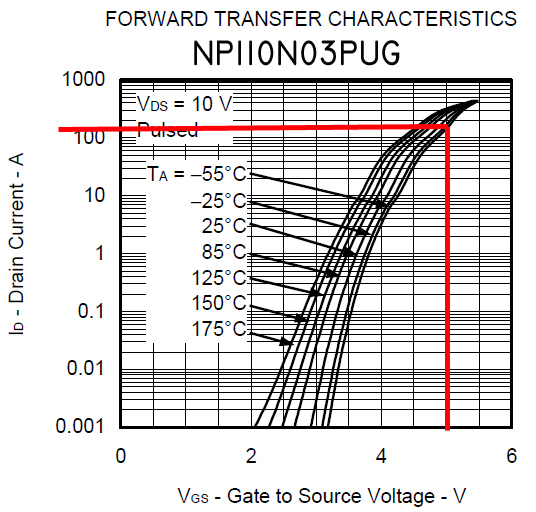

At the moment, I'm rather enamored of the
NEC NP110N03PUG FET. This little guy will
grunt over 200A at low temperatures with
a Vgs of only 5V.
Let's continue to continue . . .

At the moment, I'm rather enamored of the NEC NP110N03PUG FET. This little guy will grunt over 200A at low temperatures with a Vgs of only 5V.
Looks good, but... does the 30V max Vds present a risk of avalanche breakdown during a short-duration (i.e. not long enough to trip the timer) OV transient? The BUK962 that I mentioned above has a max Vds of 60V and the transfer characteristic chart looks even better.
But... depending upon what the crowbar pulse looks like, it might fall outside the bounds of the Safe Operating Area chart for either of those FETs.

Those two voltages are generally the same as
long as we're talking about the main bus.
Yeah, the SCR configuration has some really
desirable features, namely it's an AC device
that inherently 'latches' in DC service. Don't
need to worry about gate drive latency.
So for the moment, I'm trying to stuff a more
modern NFET into that slot. But if I could find
a suitable SCR not likely to disappear in the
next few years . . . yeah, let us lament the
evolution of selenium rectifiers.
The 'crowbar' approach that opens the control
power source yields a kind of universal configuration
in the spirit and intent of the original CBOVM-14
products. Yet it may well be that 'progress'
in component evolution makes that a
goal-too-far.
Good input sir!

PostPosted: Thu Aug 24, 2023 1:10 pm    Post subject: Next generation Crowbar OVM Reply with quote
> While the FET may indeed be suited to the 'crowbarring' of a circuit breaker, how do we insure that it maintains a saturated, on condition from the time it switches ON until the breaker opens?
> The gate voltage cannot fall below the minimum value for necessary conduction while the breaker is deciding to toss in the towel... probably 15 to 50 milliseconds.
Yeah, good point. When the FET turns on, the supply is pulled HARD toward 0V, which kills the FET's gate drive.
Also good eye. Vcc for the electronics will need to be
diode isolated from the effects of the crowbar pull down.
The capacitor across Vcc will be large enough to hold
the crowbar action ACTIVE long enough to trip the breaker.
Your comment prompted further inquiry into suitable
replacements for the SCR I had been using. Don't
know what I entered 'wrong' in the search parameters
but another look produced this little gem:
https://www.ween-semi.com/sites/default/files/2022-02/TYN30-600TF.pdf
Very sensitive gate current (10 mA). Specifically
cited for 'crowbar service'. Price is right too.
I've got some on order.
This illustrates the value of collaborative dialog.
I might well have peddled down the FET pathway
with success as yet to be demonstrated. Your
comment prompted another look into the 'devil-
we-know' technology with what appears to be
a superior solution that's more compatible with
the very low-power, comparator-timer configuration.
Don't know how I missed it the first time at-bat.
I'm headed out with the grandma and grandson for
Oregon to get my little brother married off . . .
and to let grandson stick his toes in the Pacific.
We'll be pretty much out of pocket until Sept 6
although I can peek in from time to time through
the web browser portal.
In the mean time, I'll have plenty of opportunity
to conduct some asphalt engineering. I'll knock
out an ECB to see how well we can make this
fourth generation CBOVM sing, dance and do
dishes.
Thanks for your input!
