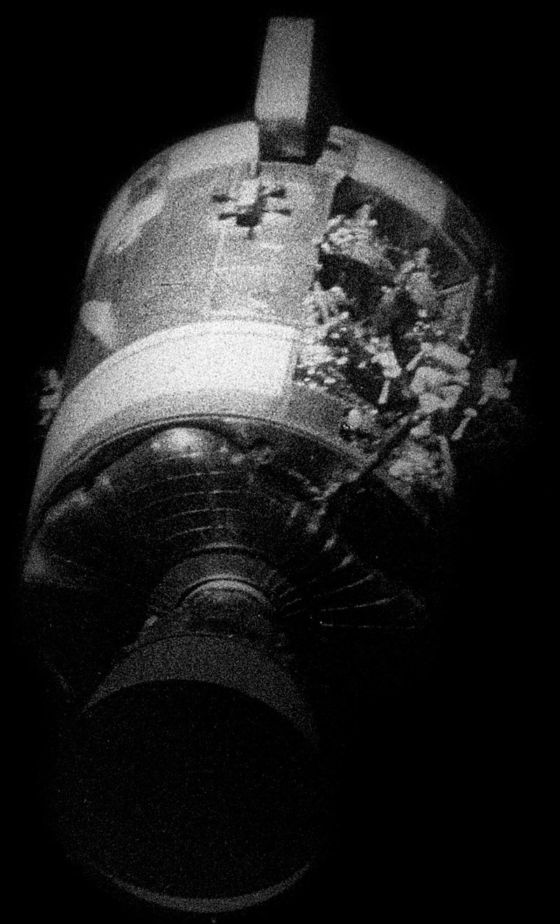

frivilous exercise. Astronauts spent
hours in their simulators practicing,
refining and documenting response to
every possible operational scenario.
Even so, their emergency procedures
manuals were decidedly silent when
it came to dealing with a failed oxygen
system blew out the side of their
spacecraft.
