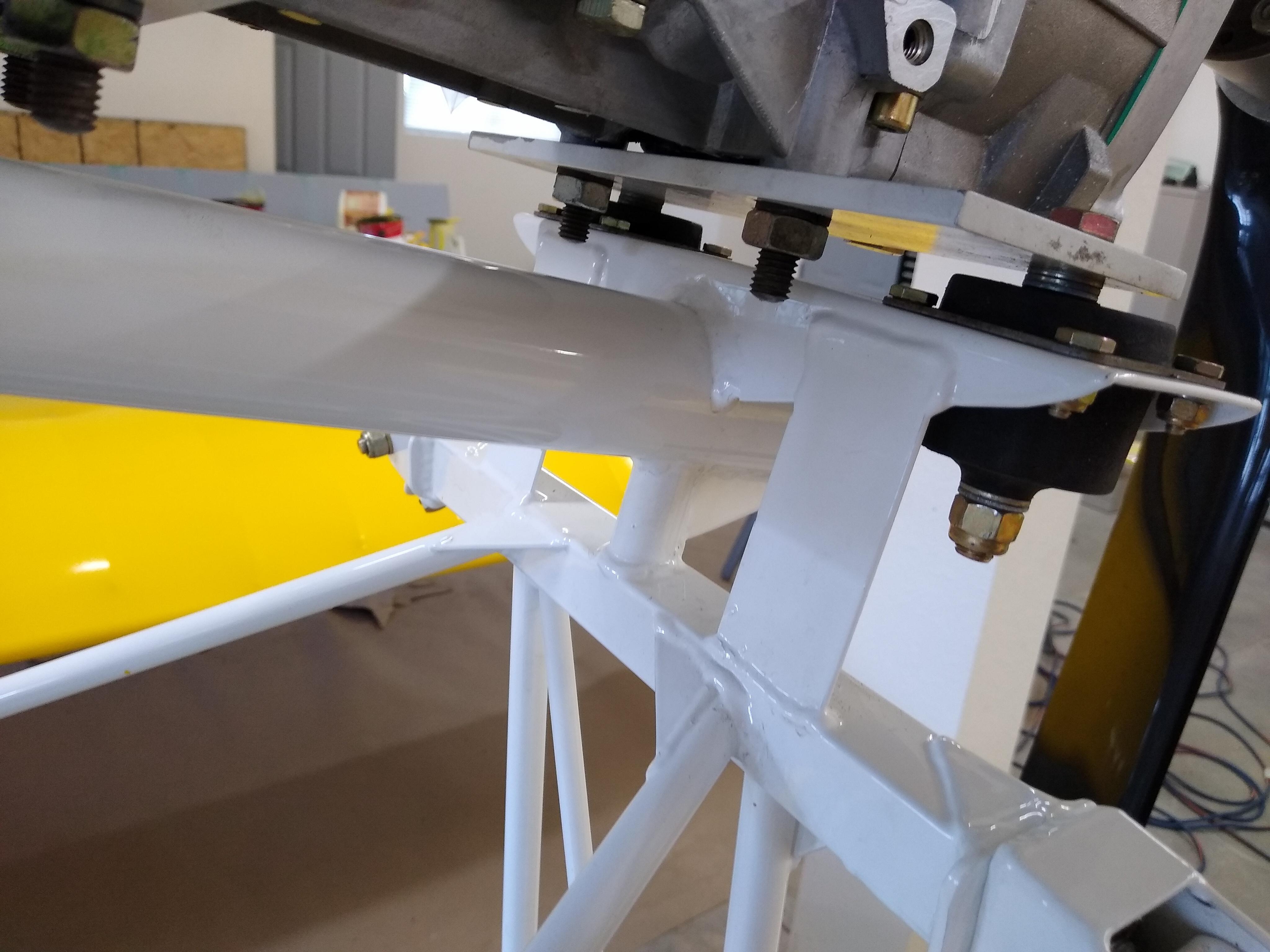

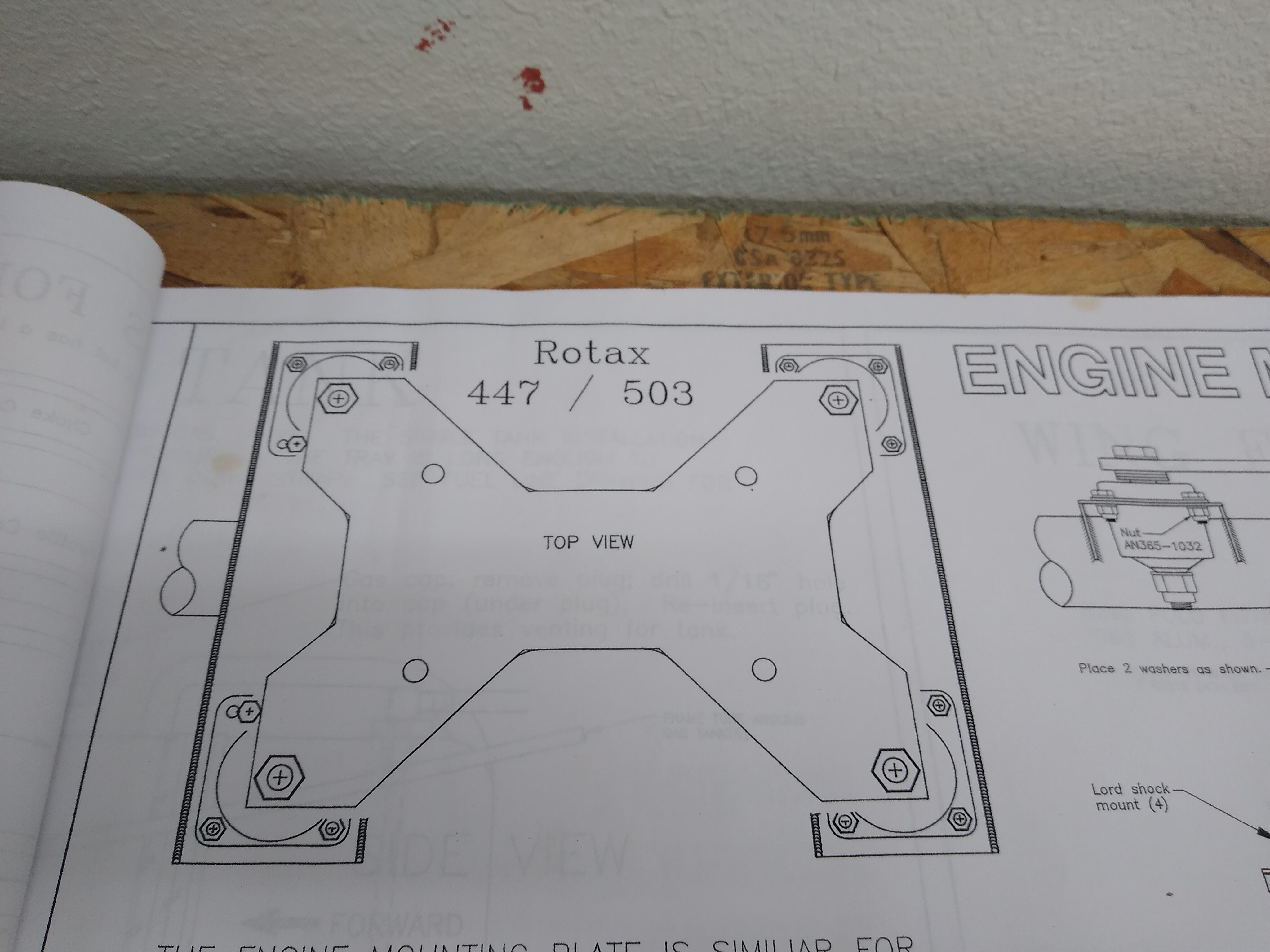

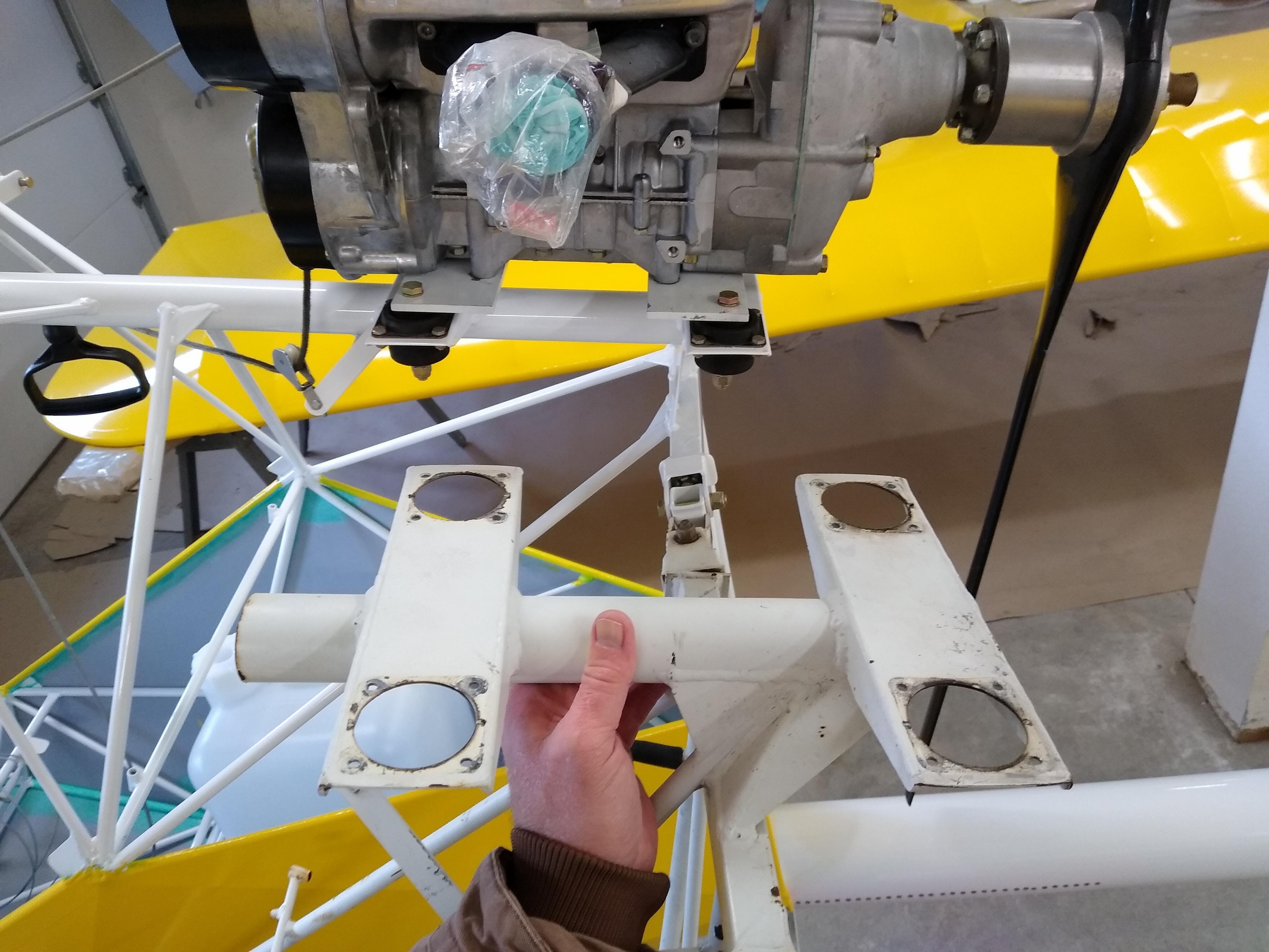

Here's some photos

I built my Firestar II around '94 - '96. The plans / instructions page 1 was copyrighted Dec, 1991.
Engine mount drawing (p15) is dated Jan 1993. This page shows two engine mount setups; one for the 447, other for 503. Both have two separate nearly identical mounting plates; but it says the 447 requires circular cutouts between the two plates to clear bottom of engine case. Otherwise, there is no difference between the two plates other than required hole spacing.
The "hourglass" shape mounting plate is NOT shown at all in my plans; but that is what I received in MY kit and it apparently accommodates BOTH engines. In other words; THERE IS NO DIFFERENCE in engine position.
In any event, don't be overly concerned with engine position / attitude as long as your prop clearance to boom tube is sufficient. INSTEAD, pay a lot of attention to WEIGHT an BALANCE calculations; with YOU seated in airplane. Someone else must read scales. THIS is what can KILL YOU; not a slight difference in engine position / attitude.

Thanks for the reply. So your plans engine plate must be different than the plates I have from about 1990. I don't know if you could see in the photos mine are just 2 plates. but the rear one has a bit of a notch machined out of it for the gearbox drain. Mine don't appear home-made at all nor do mine have any clearance holes. Plane #1 kit may be older than 1990 as I know when I built a CGS Hawk in 1991 I had bought the frame kit first, the fabric kit second, and the engine kit last. I don't know if Kolb also sold them that way too? If so my fuselage/engine mounts could be earlier than the engine.
My big concern with the engine position is solely that it puts the prop much closer (2.5-3 inches) to the aileron tubes because the engine sits further forward in relation to the trailing edge of the wing. I did measure the distance between the main spar tang and the drag link mount on both my new wings and the old wings and that dimension didn't change nor does it appear to change from the drag link attachment to the trailing edge of the wing. That means the engine is further forward for sure putting the prop that much closer to the aileron tubes. If the prop hits the aileron tubes that could kill me that's what I am concerned with.

From looking at the bracing differences on the rear engine mount U channel, I'm guessing they moved the engine forward so they could better brace the U channel for the rear mounts.
I remember reading something in the archives that people added bracing to that channel down to the boom tube/fuselage bolt on both sides when using a higher powered engine. I'm thinking maybe the factory moved it so it could be better braced.
You can see how it's braced on my plane #2 vs no extra bracing on plane #1 in the photos.
